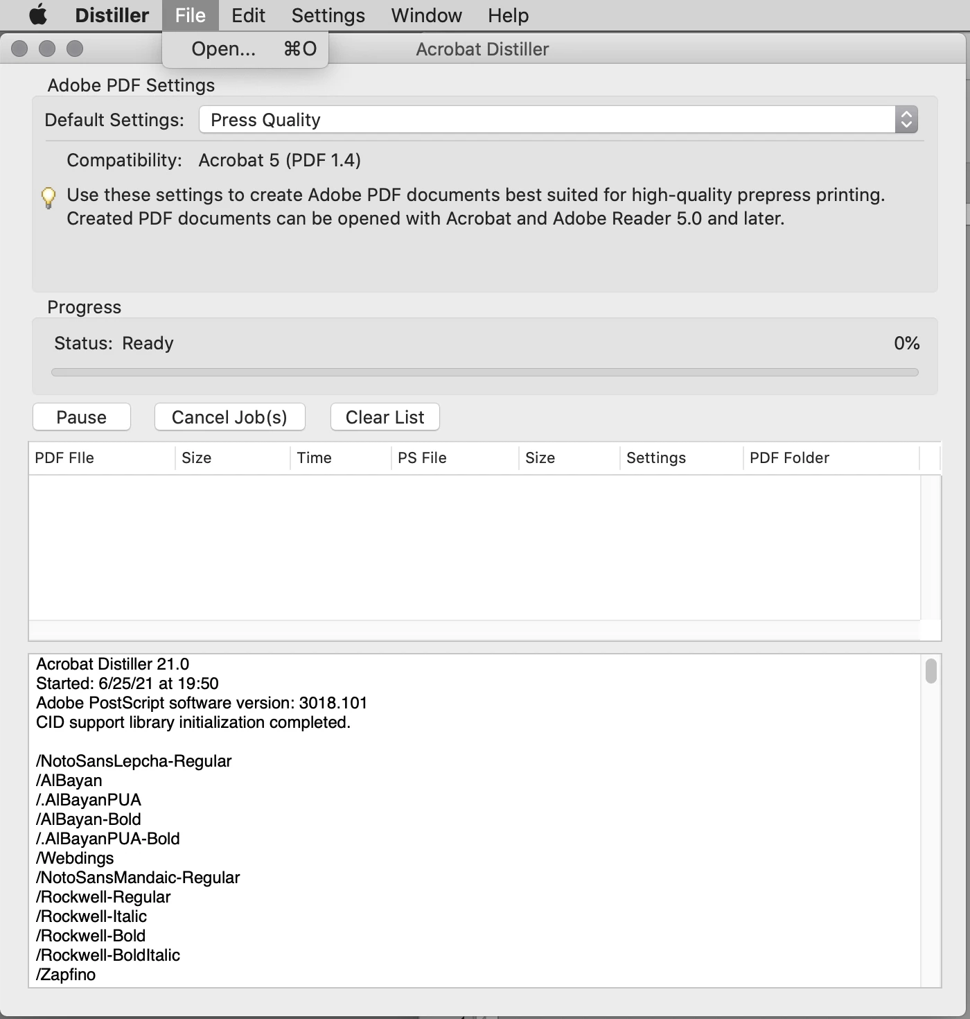

  • Open the Distiller > Choose the appropriate joboptions
  • File > Open to open the .ps file

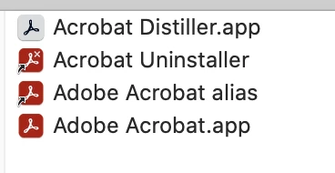

Acrobat Distiller is a separate application from Adobe Acrobat and it still comes with Adobe Acrobat, although using it is considered archaic these days because there are newer, better methods of making a PDF. It still works, though.
If Distiller is not in his Applications folder, try doing a search of his hard drive to see if it got moved into another folder.
