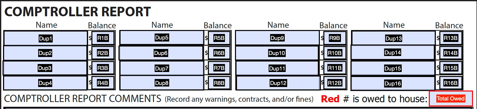

I guess I could have attached a screenshot....  Here is more of what I am trying to do...
All of the fields labeled as "RxB" will have the numbers in the (either a positive or a negative)
The "Total Owed" field should only be calculating all of the negative numbers from the "RxB" fields.
I hope this clarifies and that my attachment uploaded correct (new MacBook)

You can use this code as the custom calculation script of the field that should display the total owed amount:
var total = 0;
for (var i=1; i<=16; i++) {
	var v = Number(this.getField("R"+i+"B").valueAsString);
	if (v<0) total+=v;
event.value = total;
