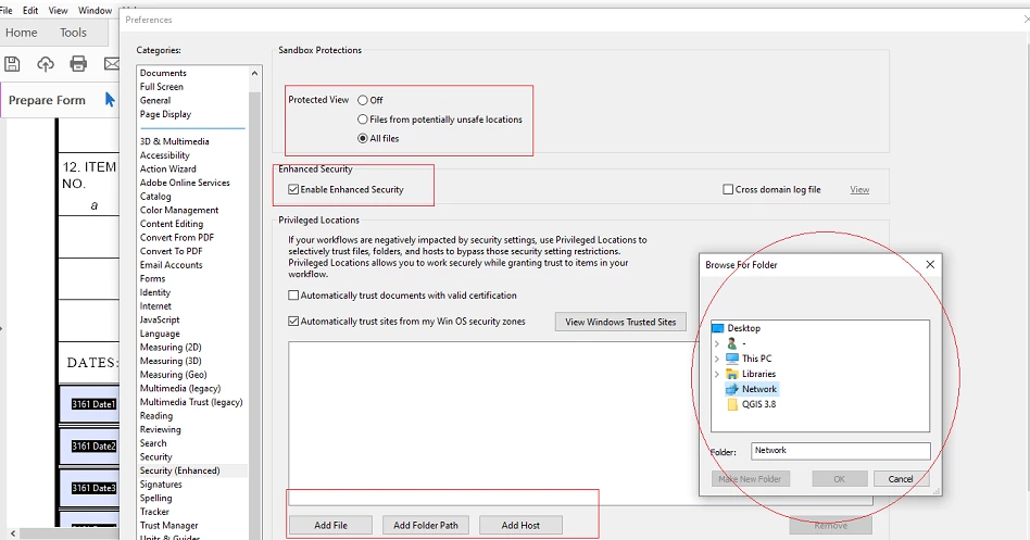

1. Below is a breakdown of additional personal notes on how I would approach the issue before messing with anything related to           networking that is already working. And I agree that it may be something with the Adobe product,
     - Starting from the end to the beginning of this threadbut we have Egnyte interacting with both of the Windows OS and  the Adobe           Acrobat configurations for network file sharing, security policies,  and how the synchronization of files and folders may be affecting           the access to resources to the entire workgroup or individually on each desktop computer.
2. I am also considering that you mentioned that your users are convinced that this problem didn’t happened before, that this is           something new going on.
     - Could this be related to the Adobe Creative Cloud service? Could it be that the clients security configurations and trust relationships           changed during an unattended update, like for example, the Sandbox Protections found in the Security (Enhanced) settings or in           the Trust Manager in Adobe Acrobat
3.  You also mentioned that Word and Excel documents on the Egnyte don't exhibit any problems when being opened from multiple           pc's at the same time, and that  it seems unlikely that this is a problem with the Egnyte
       -Seems like the MS Office files are good but not the PDF file(s). Is it one particular PDF  file displaying the problem or does this
          happens with all PDF files?
          When the users access the Acrobat PDF file(s) where are they saving them,  in a local desktop folder in their computer? over a MS           Windows shared network folder that is backed up at the Egnyte cloud regularly? Or are these PDF files saved directly into the           Egnyte cloud through each individual Egnyte desktop client accounts?
          How often are the designated storage folders for your PDF files synchronized with the Egnyte cloud folders: In other words, have           you figured out which folders need to be synchronized?
          If so, where are these PDF files being saved in the Egnyte cloud: Safety folder, Shared folder, Private Folder, Backup Folder?
4.  You also mentioned that in almost all cases the office workers are only trying to view the same pdf file with Acrobat Pro DC nobody is       even attempting to edit it not even 1st computer that opened it. One PC can open the PDF file
     - Could this be an administrative issue of file ownership/folder sharing at Windows OS level rather than the Egnyte cloud                     configuration? Could it be a volume licensing plan issue? (Per-seat, per user?)
          Are all the  .Net Framework dependencies updated on each computer that is using the Egnyte Desktop Connect App ?

Ok you offered up some really good meat-n-potatoes here and I don't know the answers to all of the questions you pose (but will try to find out next week). One problem I have is that I have to work around all these engineers who use the Adobe products extensively, and it's their computers that are exhibiting this issue. Arghhhh!
So, right now they are right-clicking on the pdf file they want to view on the Egnyte cloud (it's in a Shared folder on the cloud) and are downloading it to their desktop before viewing it (and *if* they make any changes, they save it to their desktop location then re-upload the file to the shared location on the cloud). Very inconvenient, and most times not even necessary as the odds that another of the users has the same pdf file open at that moment is low.
The way they were using it before a month or so ago, was that the shared cloud location was where they went to save any new pdf's and where they would double-click these pdf's to open them directly (via the Windows Explorer).... and that's the way they want to be able to use it, as some of the users are out on job sites with tablet pc's working remotely and they all need access to the most up-to-date copy of these pdf files. But sometime in May or June it stopped working that way more often than not, it's like pdf files are getting randomly opened for exclusive access.... I could not find any settings in Acrobat Pro DC regarding "exclusive access" when I was at one of their desks trying to troubleshoot the problem the other week; I will need to get back on one of their pc's to look for this enhanced security settings area next week and see how that is set on their pc's. Thanks! Your screen caps show potentially relevant settings I had not looked into previously I will check them!
As to whether some updates (from Microsoft of Adobe or both) have led to this situation I do not know. It's difficult to troubleshoot this when there are so many different sources of program updates and multiple pc's involved it's like how much more complicated can this get? LOL! 8-)
