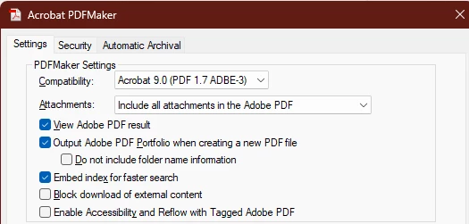

Acrobat is unable to save embedded pictures from an email in PDF. Other PDF Add-Ins are able to save with the pictures. Therefore what could possibly have gone wrong here with Acrobat?
My conversion settings within Outlook are as followed:
Compatibility: Acrobat 9.0
Attachments: All
Show Adobe PDF Results: True
give out PDF Portofolios whilst creating a new PDF File: true
Index for faster searchup: true
The rest is on standard values

     Hi ​@t.turan94,
    Hope you are doing well. Sorry for the trouble with using Acrobat Add-in in Outlook.
    When going to the Acrobat Ribbon, and checking the preferences, can you ensure if your settings look like the reference attached below?
    Please try and let us know if this helps.

    Hello Souvik,
    I can confirm I have these same Settings, I forgot to mention that I removed the tick in “Block Download of external content”. It still didn’t work, but for links directing to images from the web.
    I mainly have issues with embedded images (for example copy pasted pictures from the snipping tool)
