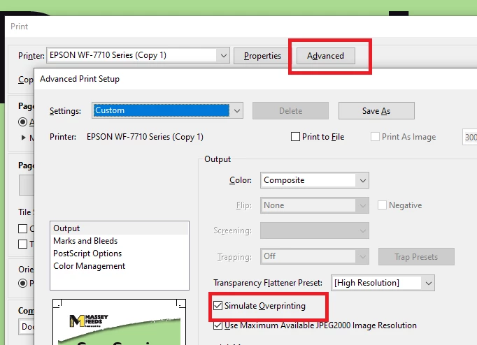

Ok, thanks, I now know what's going on. (For what it's worth, this is not a "white overprint" issue. That's a nasty thing too, but the effect is that white things disappear, not that other things disappear).
This PDF has indeed been made in such a way that it is only correct if overprint is used (as on a printing press), or simulated. If you just want to print it yourself, you can just turn on Overprint Preview when you print from Acrobat Pro, using the Advanced settings in Acrobat's Print dialog. These screen shots are from Windows, because I have no printers in any of my Macs, but it hopefully will look the same.
Now, if your problem is actually making the file so ANYONE can print it reliably in future, that's a whole different issue, but we can probably help with that too.
