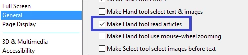

If you wish to keep the pan tool as default, you need to make changes under the preferences window.
Launch the application and go to application Preferences > General.
Make sure that only the box for "Make Hand tool read articles" is checked from the option shown below in the screenshot.
Once you make the changes, click OK at the bottom to save the changes.
Then check if it is working as you required.
