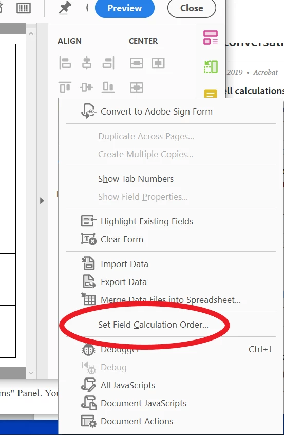

Correct answer Thom Parker
Try67 gave you the correct answer. It's the calculation order.
try67
October 4, 2023
The code seems fine. Check the fields calculation order.

Thom Parker
Thom ParkerCommunity ExpertCorrect answer
October 4, 2023
