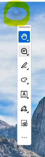

Feb 19, 2026 4:13 PM UTC
I figured it out. I hovered over the DOT. I Right-Clicked the DOT and a Double-Arrow appeared. I clicked the Double-Arrow and the window expanded to normal. That was frustrating. I hope this helps someone else in the future.
I tried to put it back in the terrible mode, so I could post a screenshot, but I can’t figure out how to do it...and I’m fine with that.

David.108
Feb 19, 2026 11:43 PM UTC
Thank you! It’s insane a 100 billion dollar company is releasing software that’s so broken
For me, I moved my mouse over the edges of the circle until I got the cursor with an arrow at each end, held left mouse button and dragged
It seems the window gets set to 0 pixels x 0 pixels when minimised

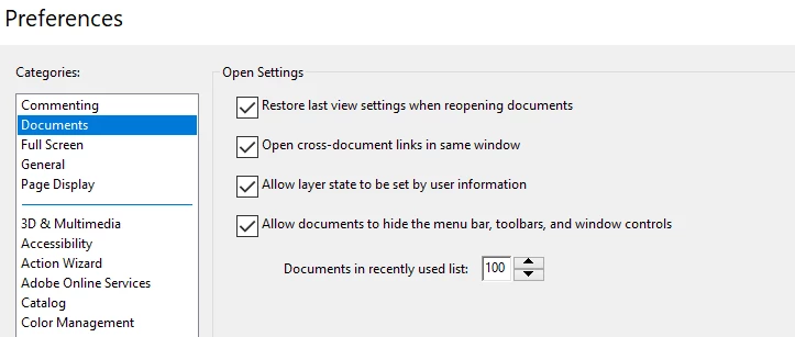

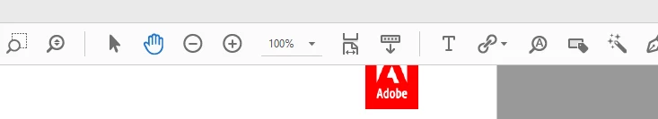

AkanchhaS8194121
Mar 31, 2020 6:41 PM UTC
Hey there,
I'm not exactly sure of your workflow, but I can surely relate it to Adobe Acrobat or Reader PDF viewer. Are you using any one of these app to open your PDF file?
May be your PDF isn't opening at its Actual Size. Rather than opening file, Open Acrobat Or Reader (whatever you have)>File>Open>select file and check.
What's the % you see in the menu bar? Set it to 100% and Actual Size.
Once done, Navigate to Edit>Preferences>Document and Select "Restore last view setting..">OK>Reboot App.
Does it make any difference?

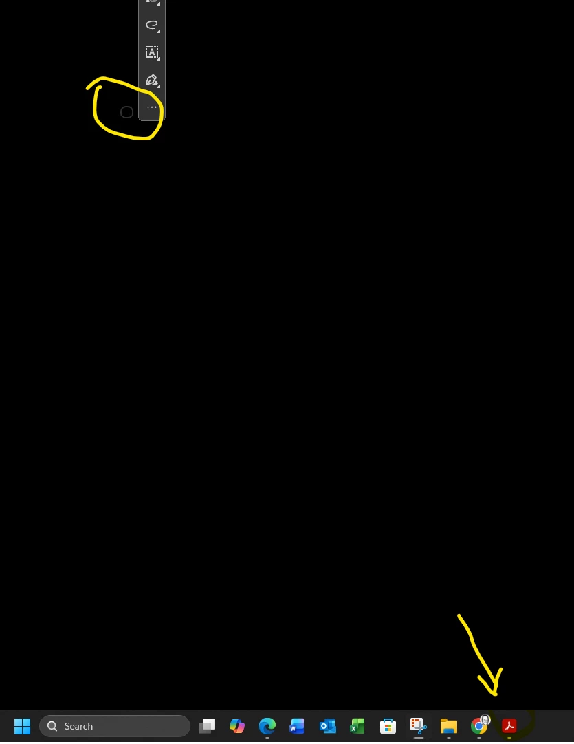

Mar 8, 2026 9:22 PM UTC
I can’t GET TO the preferences screen because Acrobat will not maximize.   All I have is a truncated part of the toolbar on the top of my screen (see screenshot).  Right-clicking the dot (see screenshot) and the double arrow only changes how I sort, but does not maximize the file.  PDF is open as shown on the taskbar. I’m in Windows 11.   HOW DO WE MAXIMIZE ADOBE ON THE SCREEN SO THAT WE CAN USE IT?????!!!
Mar 8, 2026 9:45 PM UTC
I just contacted the Adobe Customer Service robot, and the solution that worked was clicking alt+spacebar, which opened a menu that included “maximize.”  That displayed the entire window so that I can view the document.
