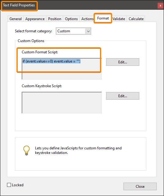

Correct answer JR Boulay
"As the custom validation code of the field enter this:
if (event.value==0) event.value = "";"
"The only disadvantage is, that i have to get my (big) sum formula also to Java, because i can´t use the field selection and additional a custom code."
You should use this script as a "Custom Format Script" instead of a "Custom Validation Script" because the Format script only modifies the display in the field, it does not change its real value which is always zero and therefore remains usable for further calculations.

JR BoulayCommunity ExpertCorrect answer
March 2, 2022
March 4, 2022
Thank you very much. That safed my day 😉

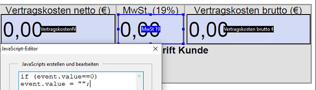

Hallo ist das immernoch eine gültige Lösung? ich gebe es hier in ein PDF Formular ein aber es passiert nichts.
Viele Grüße
Bernd Alheit
March 2, 2022
Where does you use the script?
March 2, 2022
I don't understand the question. It's a contract sheet. I want to use it on Computer with windows.
