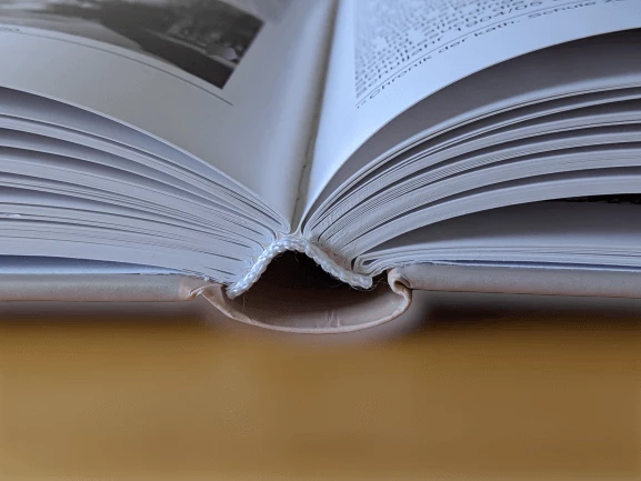

Seems like I misunderstood the perfect binding method. What I want is shown in the picture. As far as I know, the order of the pages need to be rearranged. The page increments of 4 would work out in my case.
