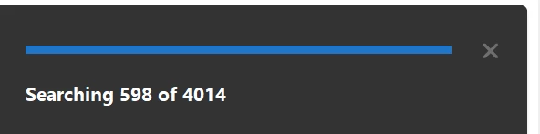

Even so when i try to search within that file, it goes for the normal slow search, instead of the indexed search. Why could that be?
Do you use Edit > Advanced Search?

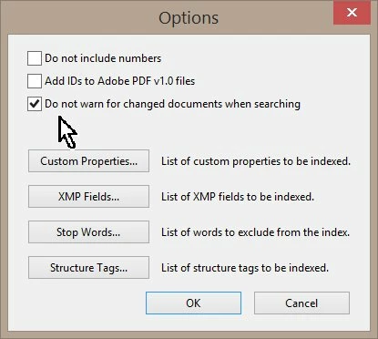

You don't rebuild the index. Disable the warning in the options of the index:

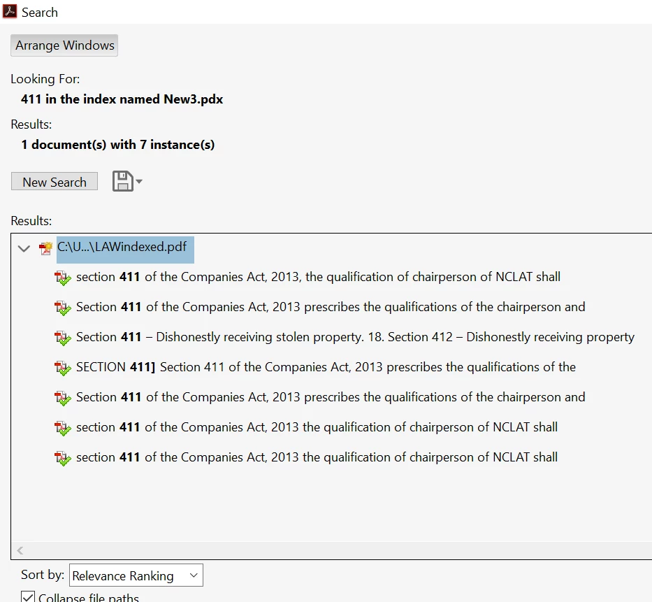

I click on OK and then on Build for the index.
After it is indexed..

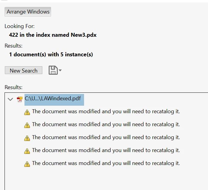

After i do a strikethrough for a sentence and then try to New search-
What did i miss?
Bernd Alheit
May 17, 2018
Save the file before you perform a new search.
