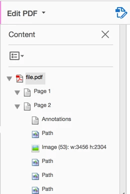

There is something seriously wrong with this PDF file. When you bring up the "Content" navigation pane and look at the information for page 1, you get nothing:
As you can see, there is content listed for the second page, but nothing for the first page. Even a blank page shows more information...
