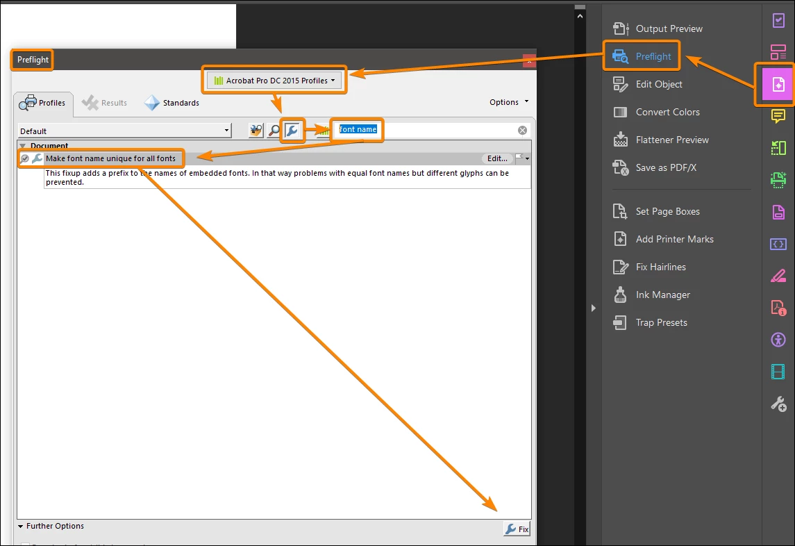

This is not a critical issue but you can easily fix it using the Preflight:

Yeah!!! I see!!! That was exactly the fix I was searching for! Thanks!

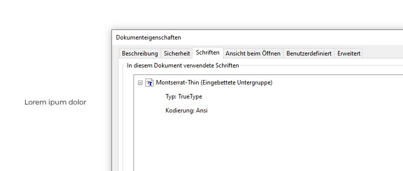

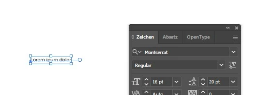

Unfortunately I still have the very strange issue that the wrong font-type is listed as embedded: i.e. I've used "Montserrat Regular" in my file, but in the PDF there is only "Monserrat Thin" listed (which I haven't used at all in the document).
Example (in german Acrobat):
So if I use the fix you've just mentioned, this will just sort out the problem with this funny naming-alarm - but I can't really say, if the right font ist embedded. Any ideas for that?

I've just realized: Could that be because the font is a "various (VAR) font"? So the font is always named after the "first" one of the possible ones that are listed in the preset-styles? That might be an explanation. I then will never be sure that the PDF has the right "info" about the typeface for the printer in it, as it has simply any name. 😞
