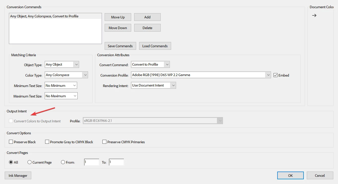

  • In Preflight, Convert Colors seems to work. Converting to AdobeRGB goes through a process and the colors on screen look identical. Converting to sRGB and they look flat. But the “embed on output” option is greyed out, and the prints are still flat.
  • I created a custom fixup to assign AdobeRGB to DeviceRGB objects, but the new PDF still prints flat.

Thank you.  As I mentioned in my I did use "Correct Colors"  in "Print Production"  and as I mentioned in my post, nothing happens after conversion.  And "Convert Colors to output Intent" is greyed out.
