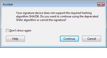

​We've been receiving calls to our helpdesk recently with users seeing an error when signing a PDF file: "Your signature device does not support the required hashing algorithm SHA256. Do you want to continue using the deprecated SHA1 algorithm or cancel the signature?"  The user can still sign the PDF but gets the error so more of an annoyance.
The timing of this error appears to coincide with an update of Acrobat Reader to v11.0.20 on Win 7, and Acrobat DC to v15.6.30306 on Win 10 machines.  According to Adobe's website, these updates came out on 4/11/17.
I've not found any specific reference on Adobe's site to this error.  The SHA1 vs. SHA256 on the signature hints at possibly an out of date driver issue based on some googling I've done but why that would start occurring based on an updated software version is odd.  Any ideas?  Anyone else seeing this? Thanks

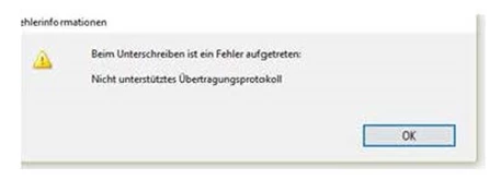

Hi to everybody,
I would like to use a certified time stamp of d-trust (https://www.bundesdruckerei.de/de/system/files/dokumente/pdf/Flyer-D-TRUST-Timestamp.pdf.pdf ) to create with Acrobat a PDF.
Although this certificate already uses the SHA256 algorithm following message is shown:
Could you help?
Thank you and best regards

OK, after further review of the articles linked, I see the screen shot of the error message in the Adobe article, Applying a digital signature using the deprecated SHA1 algorithm warning message , is not the same that the one we're seeing:
Can you confirm if this is caused by the same update that was mentioned in Acrobat DC 2017.009.20044, released on 4/11/17, as it is a bit different?  Is there a slightly different warning message shown in Adobe Reader as opposed to Adobe Acrobat?
Thanks
Rick

Dear rickfray,
The error that you see is absolutely correct for devices that do not support SHA256.
The error message given in the article is for slightly different situation . But both messages are intended to warn user about SHA1 deprecation.
Yes, you are absolutely right. We introduced this change on 4/11/17 with release version 17.009.20044.222436

May 15, 2017
Dear rickfray,jjmar56,
Thank you for reporting the issue.
We have introduced a update in Acrobat/Reader where we issue an warning message to users signing with SHA1 algorithm.
The SHA1 algorithm is deprecated and no longer secure to use. Please read Applying a digital signature using the deprecated SHA1 algorithm warning message for more details.
The default signing algorithm for Acrobat /Reader is SHA256 which is not supported by the devices in these cases.
So it signs using SHA1 but throws the warning message.
Thanks and regards,
