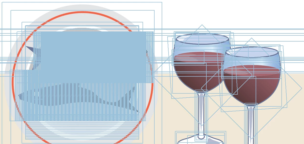

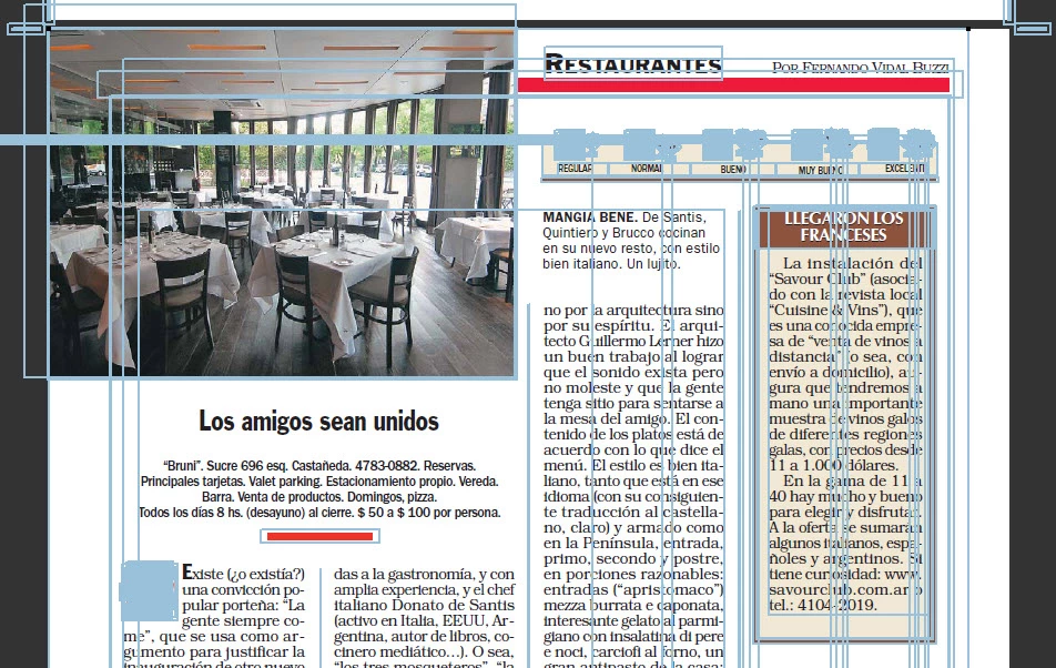

also, with the object touchup tool I discover images over images, that in reality are content stream over images...so, Its possible to flatten this images? (this occurs very often).
Image1 show all objects (object touchup tool + Ctrl-A) and image2 is the same page with zoom.
Note: this pdfs are created by indesign... olds pdfs (with smaller size and same quality) are created by quark... maybe indesign have options to handle this situation...
Best Regards!

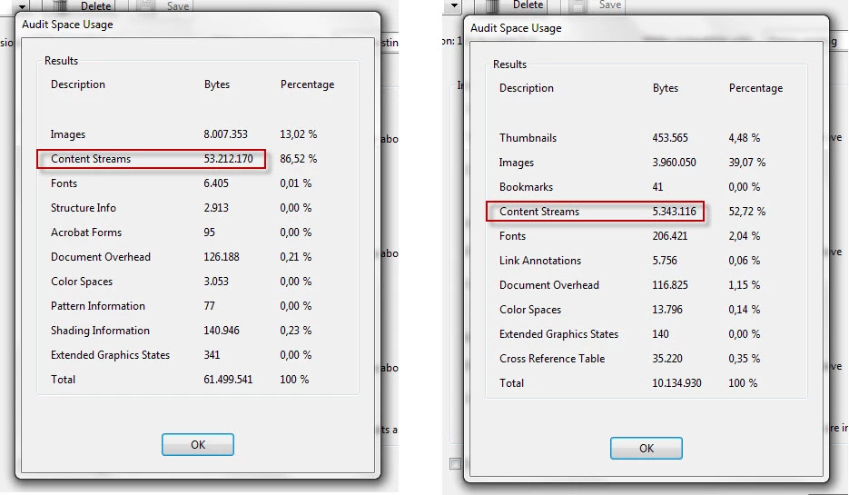

I have the same problem... near of 86% of size is Content Stream... and old document has near 50%...
may be that change is because now documents are created by indesign...
is there a way to compact this objects? I think they are little images (like icons or buttons)
