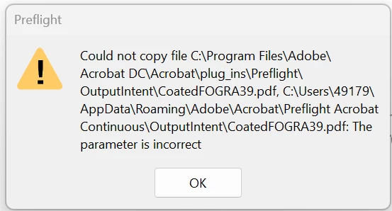

PDF to PDF/A conversion problem - parameter is incorrect
I am trying to convert my PDF format to PDF/A format, but uopn saving, I am getting the error below. Do you have any idea what is the problem?

Feb 28, 2023 9:34 PM UTC
Hi @Guest 1351
Thank you for reporting this to us.
This issue has already been reported as a bug. Our engineering team is working on the fix, which will be fixed with the following possible update.
As a workaround, for now
Click "Edit" > "Preferences..." > Security (Enhanced) > uncheck "Enable Protected Mode at Startup" and "Run in AppContainer.">Ok
Akanchha
Mar 31, 2025 4:06 PM UTC
I have the same issue and ad workaround
does not succeed. Did You find solution?
