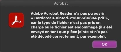

Francoise+Bou
Aug 5, 2026 7:00 PM UTC
OUI, il semblerait que cela vienne d''une arnaque d’apple ou acrobat ou autres! ... pour nous inciter à changer de matériels plus récent et performant.
Je ne crois pas que cela suffise pour récupérer tous nos fichiers.
Toujours les petites gens qui en prennent plein la “gueule”…
Dans quelle galère ils nous ont mis!
Mais, même si ils n’on n’en rien à faire, toutes les mauvaises actions se paient un jour...

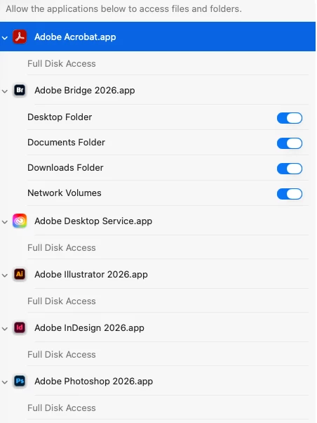

I’m having this same issue. I get the message on almost every PDF. Doesn’t matter if it's on a server or in my downloads, or on my computer. I have permissions on for everything under the sun. I've had this computer (Mac mini 2024) And this issue started happening to me last week. I was due for an update, so I did that any the issue is still persisting. My work revolves around PDFs so idk why it started doing this… I have to go into the Full Access Tab under Settings and turn it off and on in order for it to work… That’s obviously very tedious and an extra setp included for such a simple task. For example I would create a PDF via InDesign or Illustrator or from my work’s web system and having to go into settings to toggle on and off until a PDF I JUST made is able to open is very frustrating...
Also, If I am able to open a PDF, if the next one I open gives me that message, and I go back to open the first one I was able to, it won’t open and would give me the same message.
Again I have:
  • Full Disk Access on for ALL Adobe products ( I no longer have the option to choose “Allow from Downloads” or other avenues.
  • All my PDFs have Read & Write permission turned ON
  • NEVER had an issue opening a PDF unless it was corrupt (would say so in the message) whether its from my server, downloaded from online, made in Adobe, provided from a customer, Canva etc, they all worked and were able to open without granting access consistently through out the day.
  • Files not granted permission will open one minute and needs permission 5 min later. Whether I made it or downloaded it, its in my downloads, on my server, on my desktop… Nothing works.
I don't want to have to be toggling through my settings for something that should be seamless. Not sure why this is an issue (I can’t believe a company like Apple would have such a silly issue) I’ll try asking support as well since I can’t really work like this, but hoping that there’s a proper answer at some point for this here.
