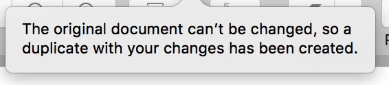

Hey, I was having trouble with this, but I figured a way around the security/Permission Password (at least in my case), though it may only work for Mac.
I opened my bank statement with (Apple) Preview, then made a small edit to the pdf (highlighted some text).  Preview then gives this notification:
Then, I can save the new pdf, just undo the original edit, and click Save again.  Now, I have an identical pdf that I can open with Acrobat and edit to my heart's desire!

Although you may think that this is a “feature” it is a major problem with applications such as Apple's Preview program which is clearly not adhering to the PDF specification. It should not allow you to edit and save the PDF file if it is so-protected. Allowing such changes opens the door for fraud.
Note that I am not accusing you of such intent, but I have seen edits of PDF financial statements used to commit serious financial fraud!
This is exactly why issuers of bank statements and other financial statements should digitally-sign these PDF files such that “edits” can be readily detected.

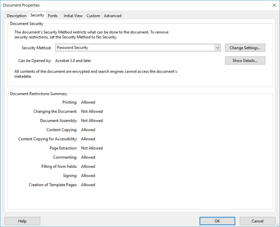

It can be tested very easily: Download the file and then open it using only Adobe Reader. If it still shows up as secured that means that's how it came, as Reader is technically not capable of applying a security policy.
Also, what exactly does it say under File - Properties - Security?
