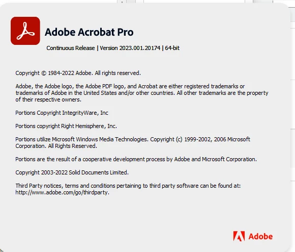

I have the following version.
I will try a reboot. I already tried to look for updates and repair.
May 11, 2023
I tried a reboot, but I still have the same issue.

Hi @Mark V.2956975591ad
This issue was addressed with version 23.01.20143. What is the version of the Acrobat DC you are using? To check the version, go to Help > About Acrobat and ensure you have the recent version 23.01.2017x installed. Go to Help > Check for updates and reboot the computer once.
Also, try to repair the installation from the help menu (Win Only) and see if that works.
Let us know if you still get the same issue
