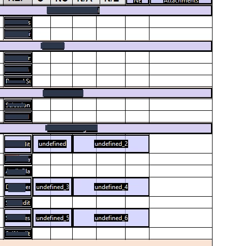

I have a table created in word that I converted to PDF. When I run Prepare form, it isn't recognizing the cells properly.  How can I adjust them so that it does? I don't want to manually create the whole form and it's large and I don't want to have to name them and give them tool tips and fiddle with sizing so they fit precisely in the boxes.

The issue is I do not want to manually name and tooltip each one. Won't that method have a whole bunch of cells with the same names? so when someone enters a value into the first all the rest are updated?

No.  It will add a period and a number to the names.  For example, a field named Text will be Text.0, Text.1, Text.2 etc.
November 11, 2025
It's also placing fields across multiple table cells for some reason?
