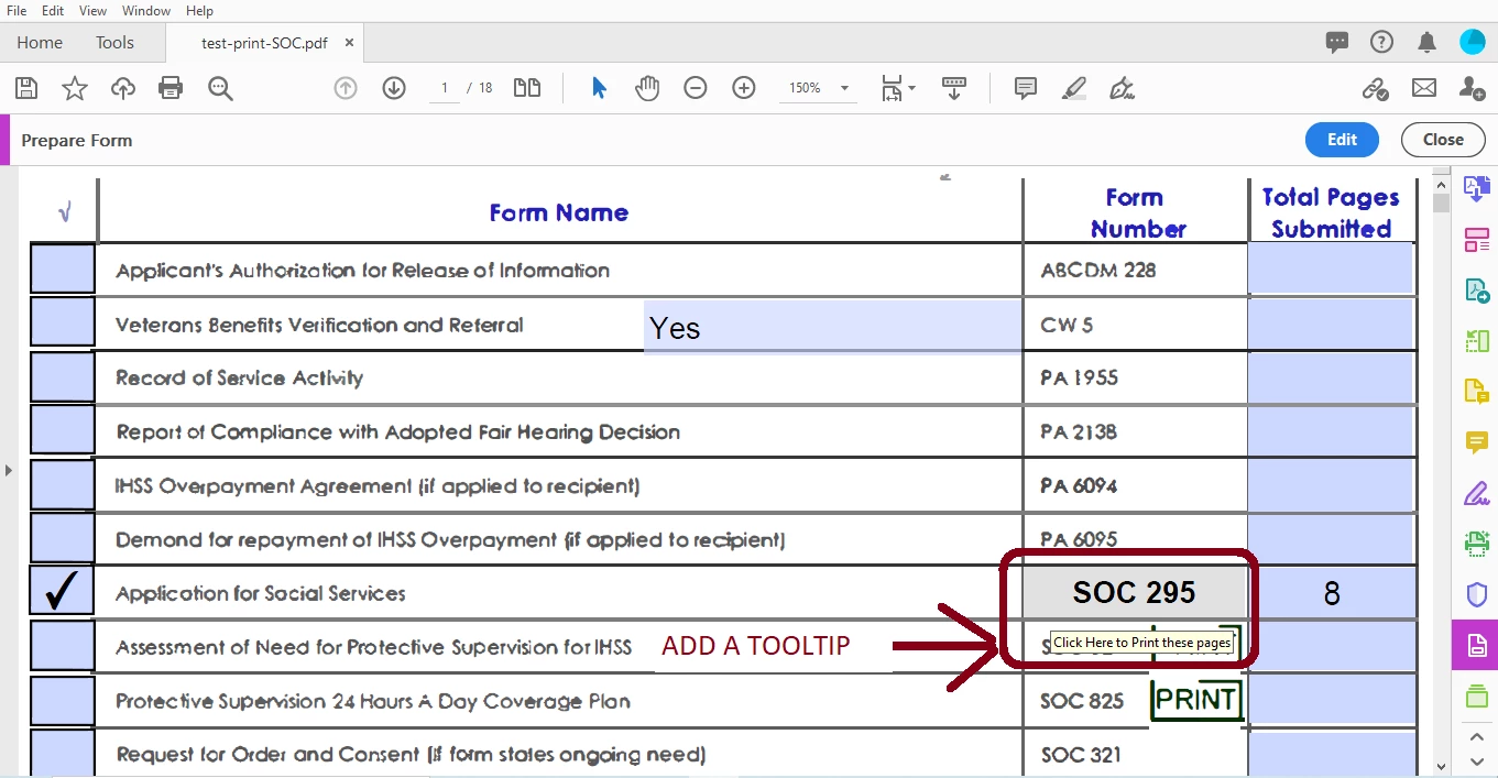

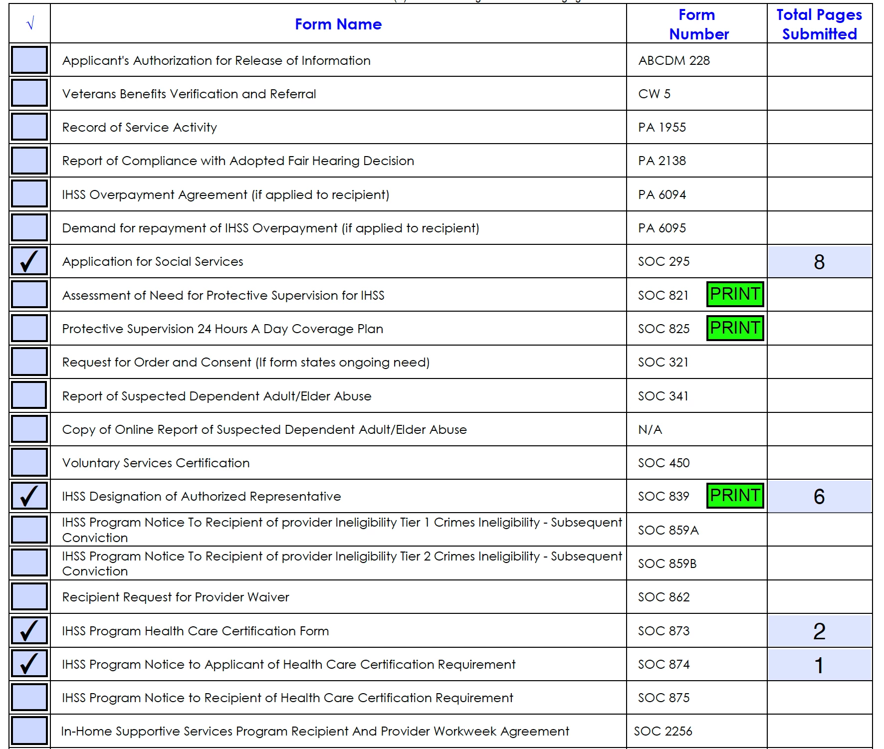

Below is a screenshot of the 2nd page of the PDF file (this page is referred to as the "journal").  As you can see,  some checkboxes are checked, which unhides the Total Pages column and shows the page number.
The PDF file contains many documents in it.  For example, SOC 295, checked marked in the journal is pages 10-17 of the PDF file.
I'd like to know if the following is possible AND what is the minimum type of Acrobat required to make it work (Reader, Standard, Pro)?
Is it possible to create a print button, that when clicked on, prints the correct docs/pages based on the checkboxes that are checked?

You can use something like this:
//this line is for a Mouse Up javascript action to print pages 10-17
if (this.getField("checkbox").value == "Yes") {this.print(true, 9,16)} ;
//use this line if you don't want the user to see the printing dialogue
if (this.getField("checkbox").value == "Yes") {this.print(false, 9,16)} ;
//Be aware that the first page in Adobe Acrobat starts at 0. So make sure that the start and end pages are input in the correct range in the script
You can test the PDF that I created using your  screenshot of the "journal".
Here is the link: https://documentcloud.adobe.com/link/review?uri=urn%3Aaaid%3Ascds%3AUS%3A76d9d119-b2f7-4c8c-9cb3-0cce90f039f2
Notice the print button is labeled so it becomes part of the form a little  more eye-appealing. See image below with a tooltip:
I hope this helps. Good luck!
By the way, it works in Adobe Reader too. You might be able to also use it in the Reader Mobile app, because it partially worked with  a third-party app like Foxit Reader. I just don't know why it doesn't work in the Adobe Reader mobile app.
