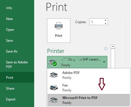

Adorobat
June 27, 2018
Thanks for the info. Could you confirm if you are using "Print to PDF" option as seen in the screenshot below:
