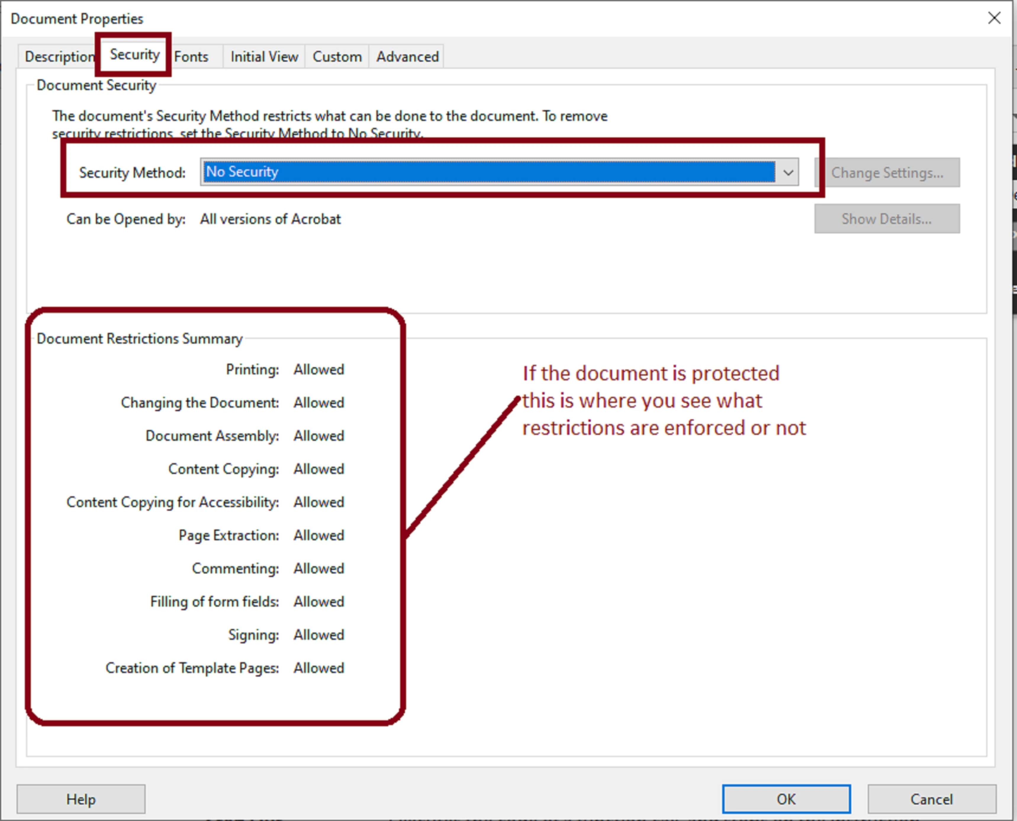

You can't distill secured PDF files period.
And Gmail has nothing to do with how you set up your default PDF owner in your system.  Viewing and printing from Gmail's own PDF software has nothing to do with Adobe Acrobat Pro.  Do you actually  have an active Adobe Acrobat Pro DC paid subscription to begin with?
Using the printing method that you just described was clarified by Dov.

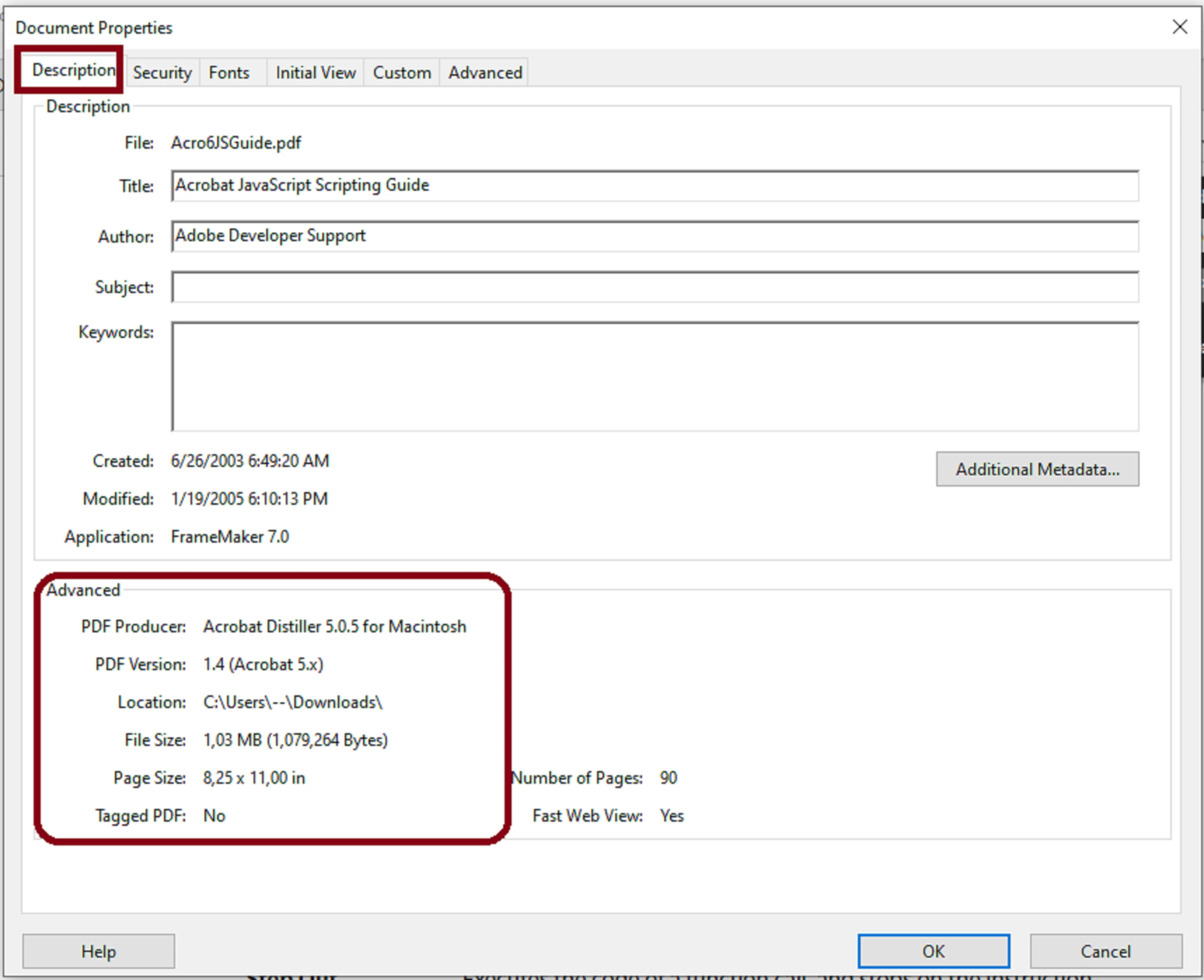

If you have Adobe Acrobat Pro DC installed  in your computer you should be able to right-click in your opened document and select "Document Properties" from the context menu.
Or simply click on "File" from the file menu, and select "Properties". This is how you check what the original document was created with and if it is secured or not .
See slides.
The  dialogue box window that will open up next have different tabs.
See the Security tab?   That's what you need to be looking into.
