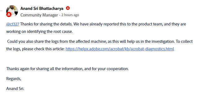

    Hello ​@mapsypam
    I hope you are well, and sorry for the trouble. Assuming you have installed the latest build, which addressed this issue: 26.001.21789 Out of cycle update, Aug 11, 2026. And, tried the suggestion from this published help article on this: https://helpx.adobe.com/acrobat/desktop/troubleshoot/print-scan-issues/unable-to-print-a-pdf-with-mixed-pages.html
    But as you mentioned, you are able to print either legal or letter, but not both. Are you getting any error message on the screen while printing? What happens when you give the print command? Also, can you please collect the fresh logs after installing the latest build so that we can get that investigated by the product team? To collect the logs, please check this article: https://helpx.adobe.com/acrobat/kb/acrobat-diagnostics.html
    Thanks for your cooperation on this.
    Anand Sri.

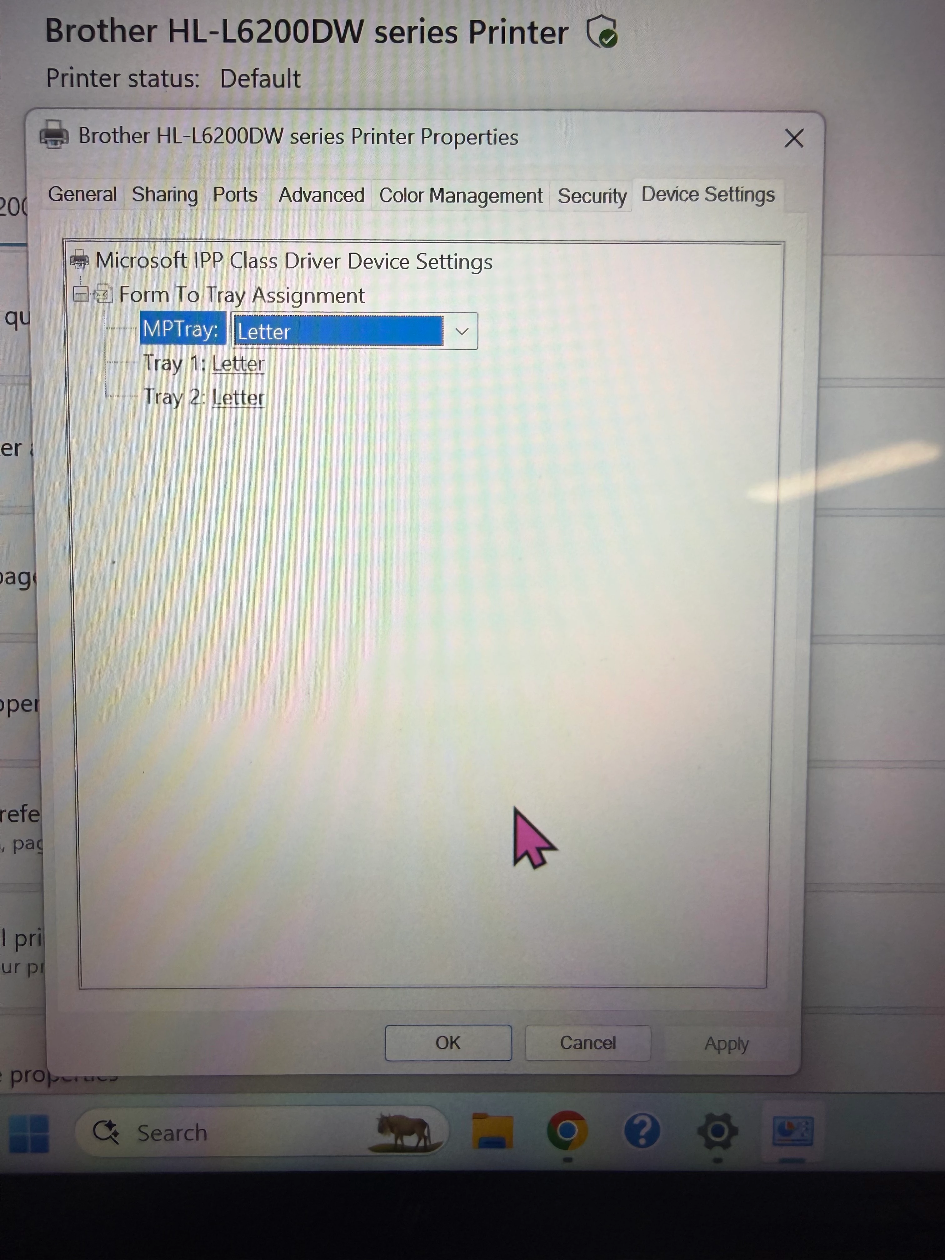

    August 6, 2026
    August 6, 2026
    There is no pdl near bottom for me and I cant see anything saying available languages on any tab there

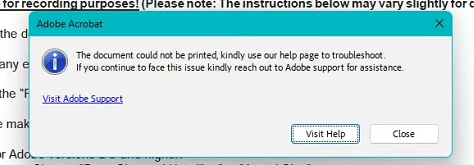

    A few employees at the company I work at are experiencing this issue as well. Windows 11, Acrobat 2026.001.21771 64 bit
    When they attempt to print their file, an error comes up saying “This document can not be printed” and when that is closed, a second error comes up of “An error occurred while printing this document, kindly use our help page to troubleshoot.”
    We have tried checking Choose paper source by PDF page size and unchecking enable protected mode at startup.
    I’ll be checking this thread periodically, so if any other tips are identified, please reply to this.
