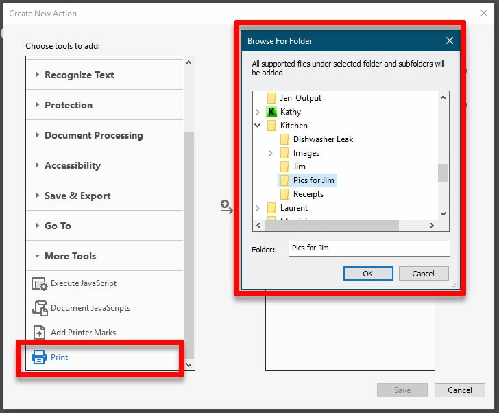

It might be worth trying to make a custon Action using the Action Wizard.  If you follow the prompts, it's pretty straight-forward.  You could build it to include files in a specific folder, or have the action prompt for the files to be printed.
I hope this helps.
My best,
Dave
