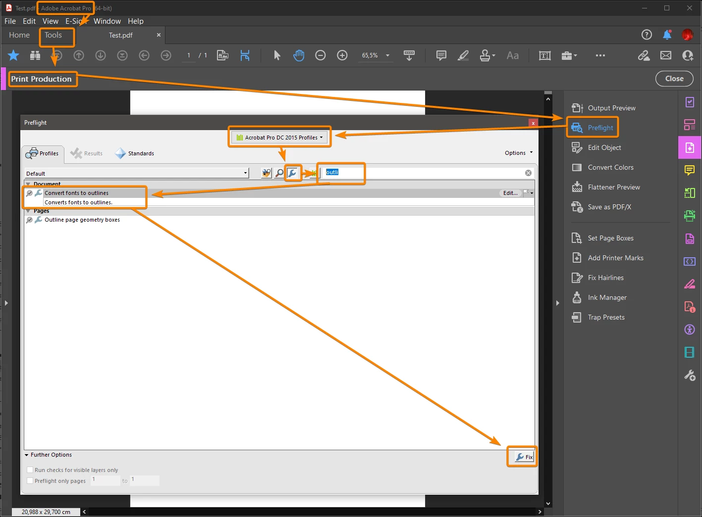

JR Boulay
JR BoulayCorrect answer
Dec 7, 2022 11:25 AM UTC
This is not a good practice.
There is a dedicated feature that is simpler and faster:

JR Boulay
JR BoulayCommunity ExpertCorrect answer

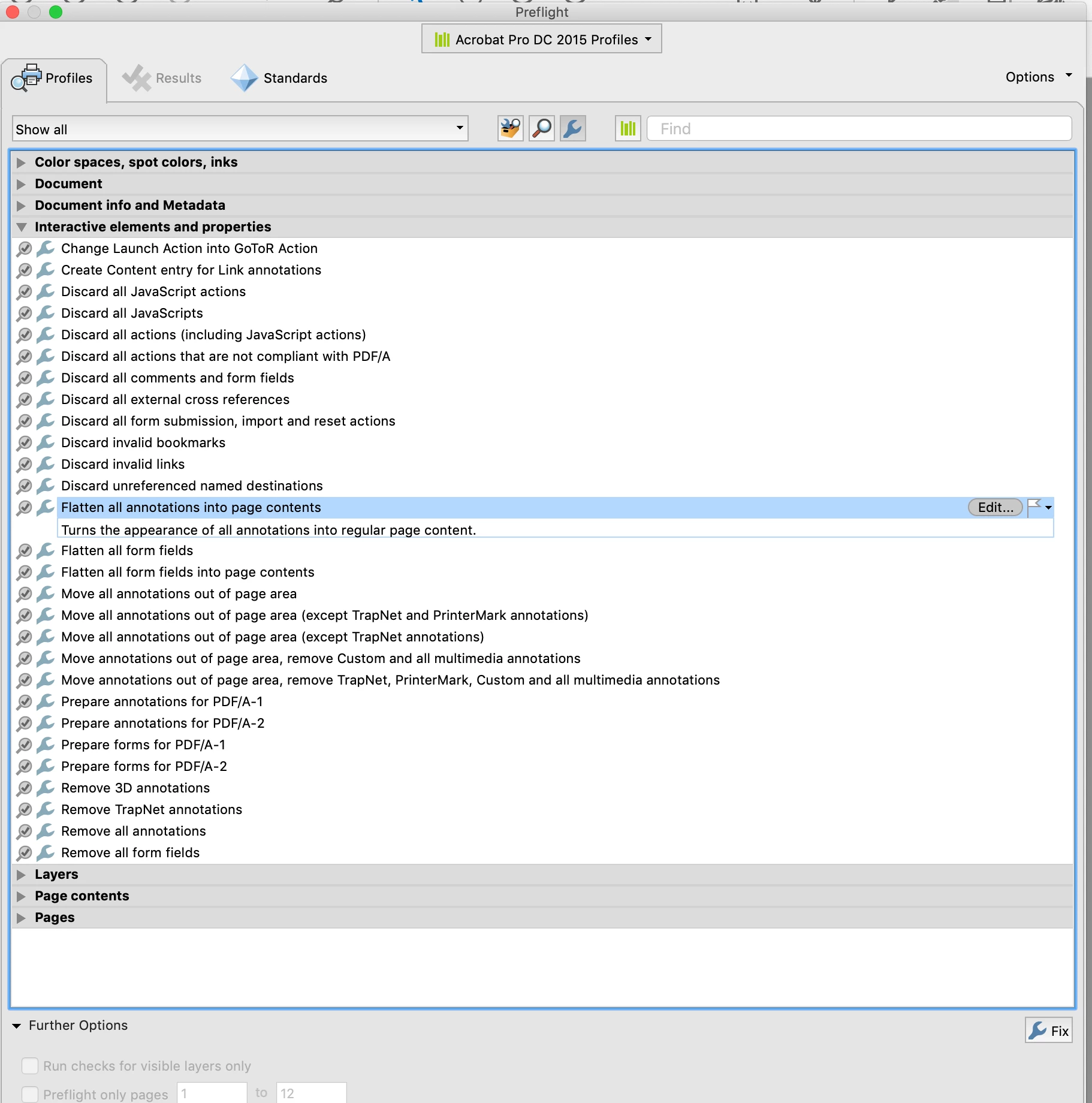

Mar 12, 2022 4:55 PM UTC
There is another single preflight fixup you can try (under the blue wrench icon), it's probably the same fixup, but without changing form fields.
Any comments should appear on the list of comments when the comment tool is selected and the list is expanded (little triangle is turned). After running the preflight, the comment list should say "No comments yet". If you are still having issues, can you upload the actual pdf so we can check it? Do you need to outline the type? There are many good reasons not to do that.

Mar 13, 2022 3:13 PM UTC
Exporting to a PDF/X-1a (or converting to PDF/X-1a in Acrobat) is a pretty safe choice to meet the printer's specs, however, your pdf has text added as a pdf comment and there is a chance this won't print, which is why it is important to flatten it using the preflight profile I mentioned. (It's usually better to add the code and all other elements in the original application). Also, converting a pdf to PDF/X-1a appears to move the text comment out of the trim area, so your code would not appear in your ad when printed.
Check your final pdf in Acrobat using the Output Preview tool to check the separations. Your Acrobat page display preference to show overprinting should be set to "Always".
I suspect they don't actually need the type converted to outlines, this sounds like someone forgot to update their specs somewhere. I would give them a quick call and ask them if PDF/X-4 is acceptable, and leave it at that.
