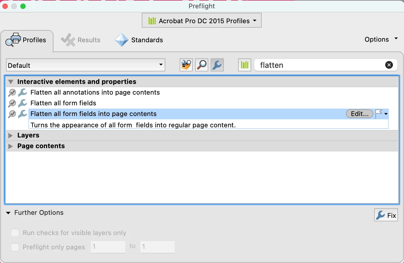

You want a pdf that retains the rotated pages, always prints the stamps & markups and should protect the signatures from being easily copied, is this correct? Firstly, anything that can be viewed can be copied in one way or another. Stamps and markups can be flattened into regular page content using a preflight profile, as Bern mentioned (see attached screen shot). You could add security to the pdf to prevent editing, but it's not hard to get around that level of security. Another option is to use a preflight profile to convert the page content into a high-res images, but that would increase the pdf size and create accessibility problems. Printing pdf to pdf can cause unexpected changes and is rarely the best option. You could create a layered pdf, with the top layer containing an invisible image, which would confound many, if not most users when they try to select and copy a signature, but this could be a problem if a non-Adobe viewer that does not respect layers is used.
