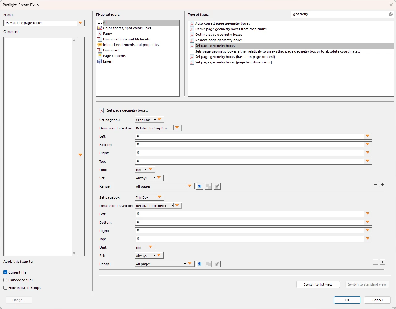

OK, so after a lot of time, I have come to a conclusion that the way JavaScript changes the page boxes is kind of problematic.
The only solution to this was a creation of a custom preflight profile that would validate those boxes after the JavaScript changes them.
From that point on, the posted script works as intended.
Hope it helps someone else.

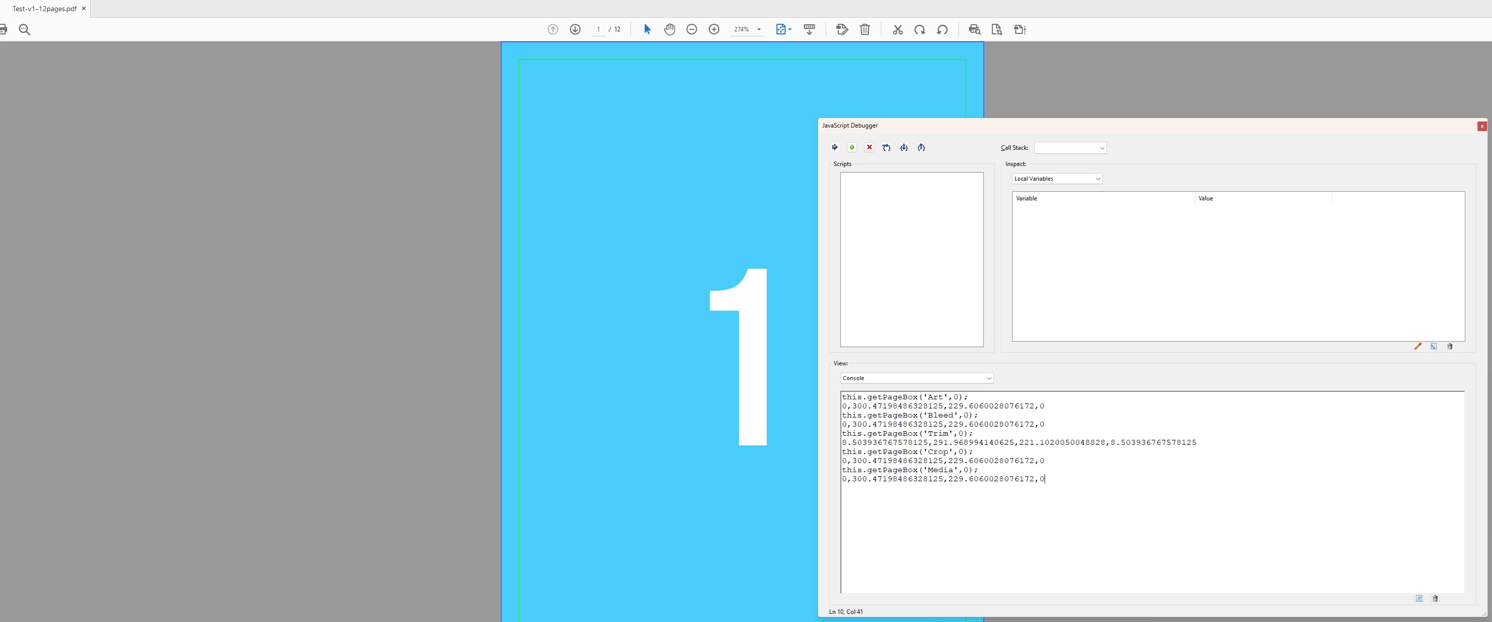

I revised the code a bit but to no avail. And then I checked the javascript console. I have a strange, unaccountable feeling that Acrobat is lying to me, right before my eyes. Let me explain.
I have opened the document I included in the original post. Checked the console with these commands and results:
this.getPageBox('Art',0);
0,300.47198486328125,229.6060028076172,0
this.getPageBox('Bleed',0);
this.getPageBox('Trim',0);
8.503936767578125,291.968994140625,221.1020050048828,8.503936767578125
this.getPageBox('Crop',0);
this.getPageBox('Media',0);
Here is a screenshot:

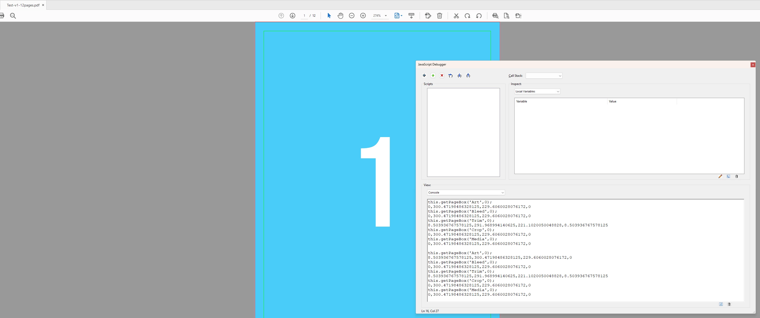

After that, I executed the script from the Menu Item and got these results:
//After the script
8.503936767578125,300.47198486328125,229.6060028076172,0

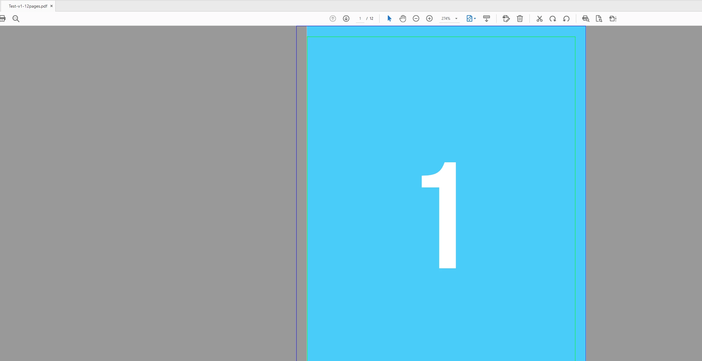

A proof of that:

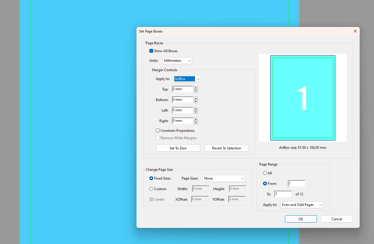

Not only are the visual guides off (the red rectangle for the ArtBox should be on the green TrimBox on the left - according to the javascript console) but the Set Page Boxes tool in acrobat does not register this change either:
Do you know what is happening?
