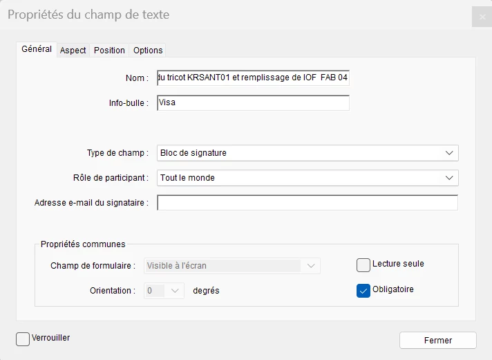

try67
July 18, 2025
If you're using the old Acrobat UI, click on Tools - Prepare Form and then on "More" at the right-hand side of the window and then on "Revert to Acrobat Form".
If you're using the new Acrobat UI go to Tools and search for "Prepare Form", then click the "three dots" icon next to "Prepare a Form" on the left-hand panel and then on "Remove e-signing options".
In the future, when creating the form for the first time do not tick the box that says "This document requires signatures", as it converts it to an Adobe Sign form, which has limited functionality.
July 24, 2025
Thank you all for the answers. The reason it did not work was because I clicked on "This document requires signatures"...

July 18, 2025
Dear Meenakshi Negi,
Thanks for the reply. Here is what appears for me when I look on the properties of the "Champs de signature":
I don't have the ability to configure it as a signature but only as a text.
I have the last version (downloaded yesterday) and am on Windows 11 Professional.
Thanks!
