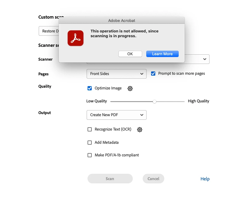

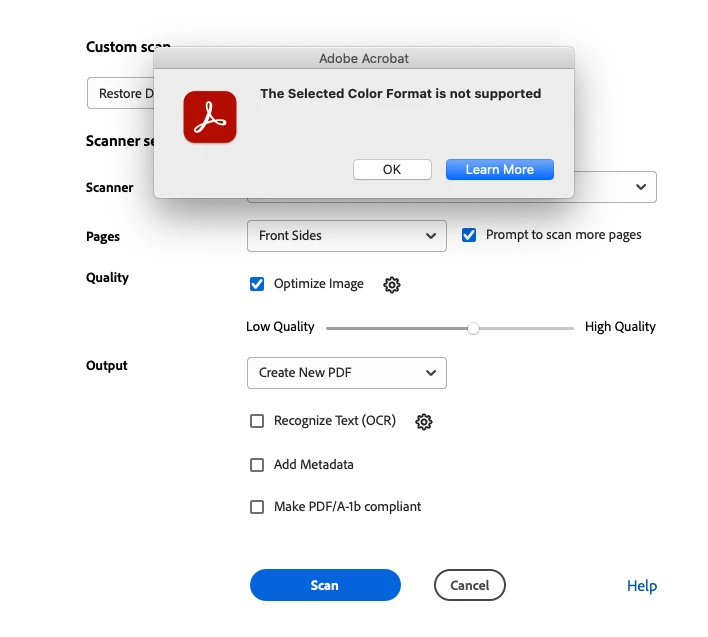

I'm getting all kinds of messages when trying to create a PDF from scanner. I will go to "Create" from scanner and click "Scan". I immediately get an error "Failed to open session on device (-9921) and then it will scan. In the next screen, I will select the item I wish to scan and select "Color" and click "Scan". Again I get another error, "The Selected Color Format is not supported". I could not do anything except Force Quit out of Acrobat since it would not let me do anything. After restarting, I went through the same scenario and when I got to the same spot that it locked up, I was able to click "Ok", but then it threw another error when I selected "Scan" stating "The operation is not allowed, since scanning is in progress", but the printer/scanner is sitting idle.
I am able to accomplish the scanning using the utility program that came with the scanner, but I would prefer not having to go through extra steps. Any help would be greatly appreciated.

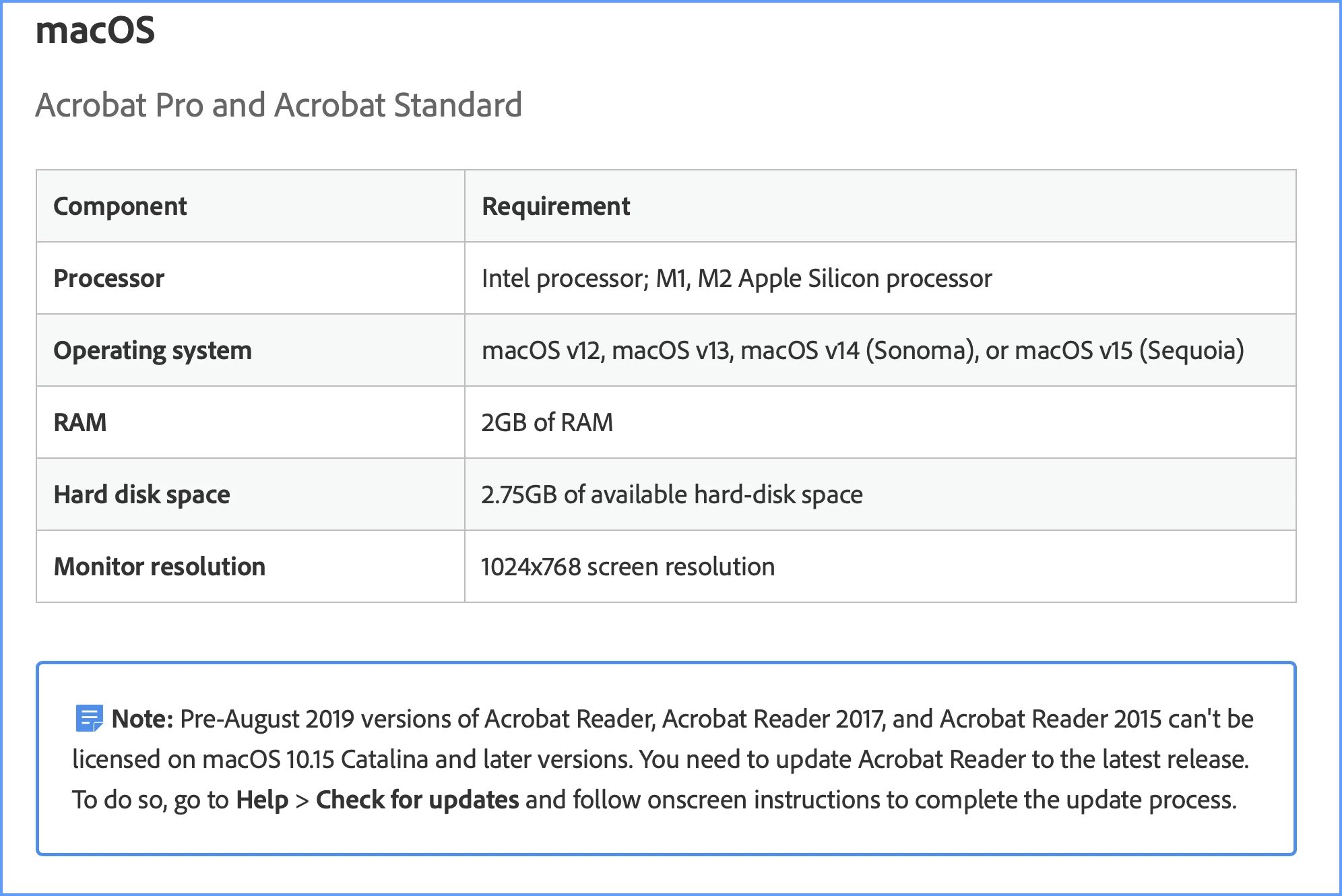

Hi, @jodmcc49, I just happened to relook at your original message and you state you're on Catalina OS?
There's a problem there. As shown on https://helpx.adobe.com/acrobat/system-requirements.html
Here's a screenshot:
 Sorry I didn't notice that earlier.
