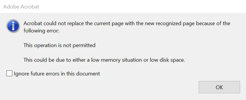

May 10, 2018 3:22 AM UTC
I've tried all of the aforementioned links to no avail. I am however, getting a different error message now...
Then after clicking OK I get:
