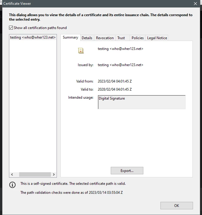

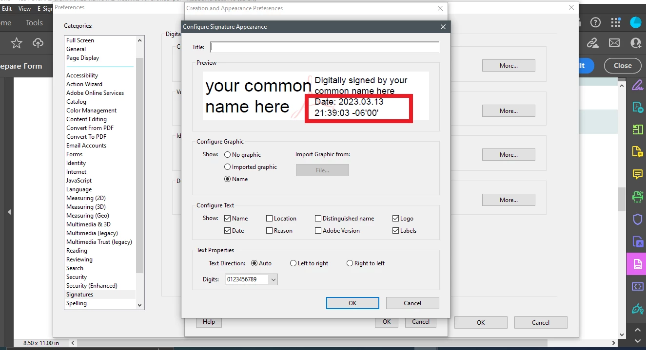

As far as I was able to test before replying back to you, the time stamp validation looks like this when I change my date/time settings to an UTC zone:
While selecting Universal Coordinated Time zone will obviously display automatically the Zulu identifier (Z) instead of an 00'00' offset, shown below:
