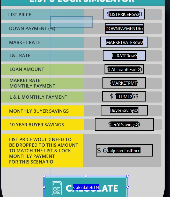

I'm trying to  implement the JS logic I have here in this codepen that is calculating the present value of a loan based on a corresponding payment, and then dividing that total by a the inverse of a downpayment % which is ( 1 - downPaymentRate ).
In the codepen I'm getting expected dollar amounts +/- a few cents in comparison to the  PV formula as it exists in an excel spreadsheet. For whatever reason when I implement this same function in the adobe PDF it's giving me a value thats off by over $8000. I'm not sure what the difference is in the formula perhaps someone else has seen this problem before.

when I use the same values as shown in the js file of the codepen I get a substantially different answer. Is the Math.pow function operating differently in the pdf? I'm so confused.
October 18, 2023
well, i've logged every value that is being input and it matches the values going into the excel formula but for whatever reason adobe is outputting a different value.

So where exactly is the code placed?  Is it a caluculation script?  On which field? and what is the input field?
It looks like the intended target is the "adjustedListPrice" field.  If this is a calculation script on that field it probably won't work. You can read about how to write calculation scripts here:

code is a custom calculation placed inside the calculateBTN
the calculation is run via mouse down action.

I would suggest performing some debug. Run the code manually, line by line in the console window and see where the calculation is going off the rails.

Thanks, I've been logging each variable independently to match them with the ones in my excel spreadsheet. Haven't found it yet, but going to continue debugging these logs.
