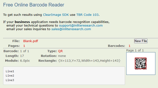

How are you doing the input?  I used the following custom calculation script and it worked for me:
event.value="line1 \r line2 \r line3";

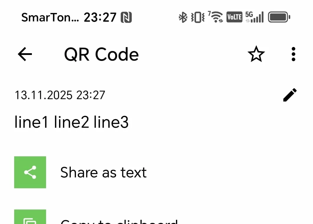

ian_8519Author
November 13, 2025
Upon using the barcode scanner, the output is formatted as a single string containing the values "line1 line2 line3". The qrcode.js library produces a QR code that encodes data as three distinct lines.

I used this free online barcode reader to read the QR code:
https://online-barcode-reader.inliteresearch.com/
