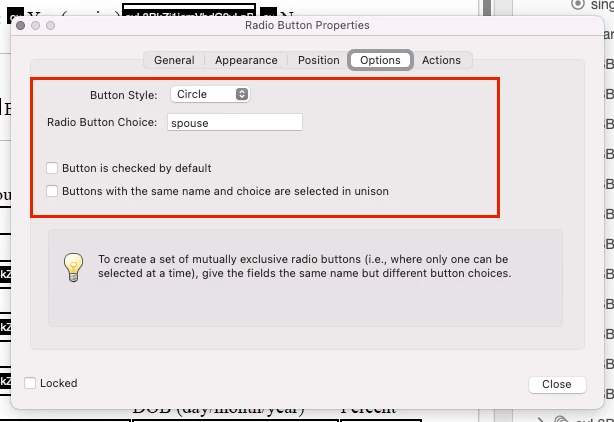

This is what my current fields look like:
The radio groups share the same name but different values. Of course you wouldnt be able to tell by that screenshot because of the  menu design...
Also, its seems that if I toggle any of these 4 options highlighted below:
Even if its off and on again, or add a space to the end of the choice, or change the button type to a circle. the functionality returns.
Right now I have a basic for loop through every field but I would like to limit it to radio button groups not include text fields. Is there a way to for loop through radio buttons and toggle on of these 4 fields
