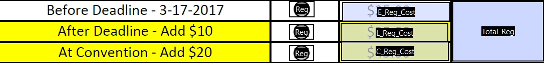

I have created a registration form. I have created 3 radio buttons.
1 Radio Button - #E_Reg
2 Radio Button - #L_Reg
3 Radio Button - #C_Reg
They are all in a group named Reg.
If someone selects the button 1, I need a field named Total_Reg to populate $25
If someone selects the button 2, I need a field named Total_Reg to populate $35
If someone selects the button 3, I need a field named Total_Reg to populate $45
Basically, it is 3 different registration prices. If they are early, they get $25, if they are late it will be $35, if they wait until the convention then it will be $45. Only 1 can be selected, so that they are charged appropriately.

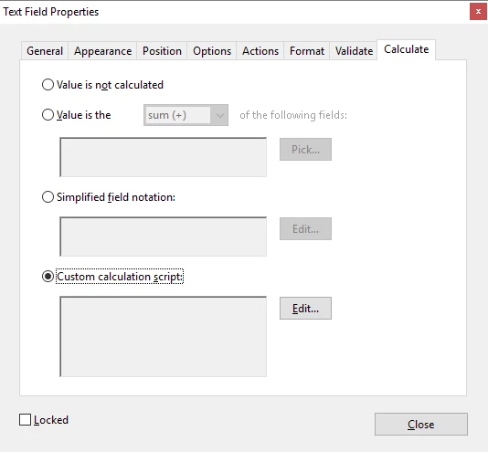

Use this code as the custom calculation script of the E_Reg_Cost text field. Adjust it accordingly for the others:
if (this.getField("Reg").value=="#E_Reg") event.value = 25;
else event.value = "";

I have entered and modified it according to the 3 Registration costs. Unfortunately, I am still not receiving anything in the Total_Reg field when one of the 3 radio buttons are selected.
E_Reg_Cost:
L_Reg_Cost:
C_Reg_Cost:
Total_Reg:
