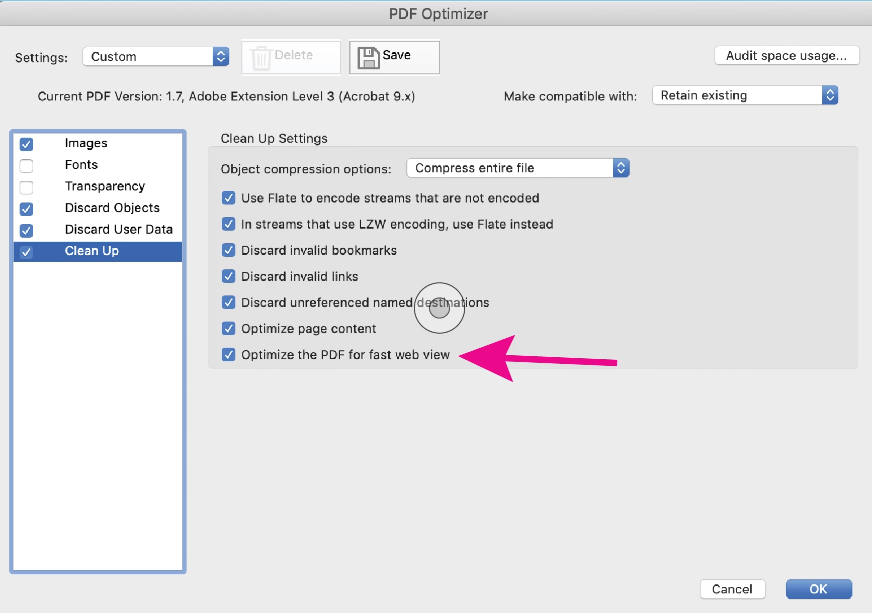

Have you tried optimizing your PDF in Acrobat? File> Save as other> Optimized PDF. Can you downsample & re-compress your images? I suspect that would help your display issue, also, select all of the discard and clean up options (unless there is something there you need) this can often result in significant PDF size reduction. If this doesn't help, try it again but under Make compatible with: select Acrobat 9 or later.

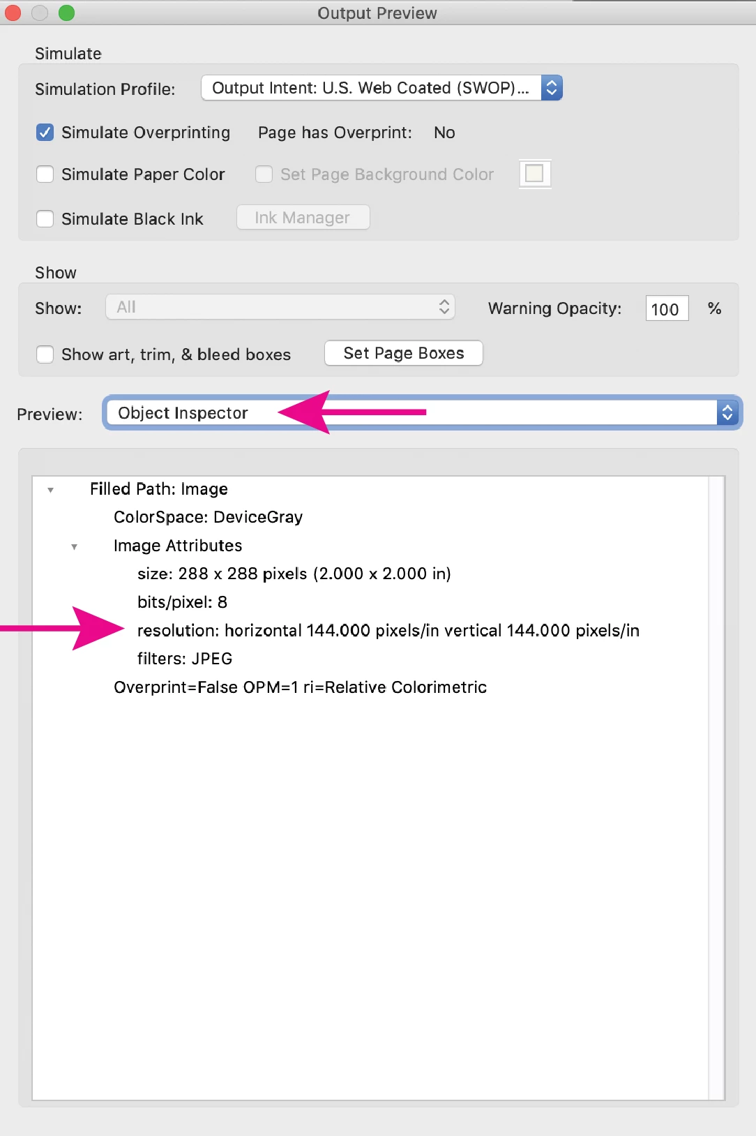

Try optimizing in Acrobat without downsampling, the size of the PDF may be reduced without any reduction in resolution or quality, possibly fixing your display issue. Adding compression (zip) to the images may also reduce the size without downsampling. While I understand you don't want any reduction in in resolution, I wanted to mention you can use Acrobat to check the effective resolution of your images- Output Preview> Object inspector. There is a point where higher resolution won't improve the printed result, depending on the printing process and the image content. As for the physical size limit, if you are referring to the size in bytes, I don't think there is a limit, but any PDF larger than one gig can be problematic to transfer and view, particularly on older systems. Other things you can try- Save as, using one of the PDF/X settings. Change the Page display preference to show large images (if it's off), although this won't help other users.
