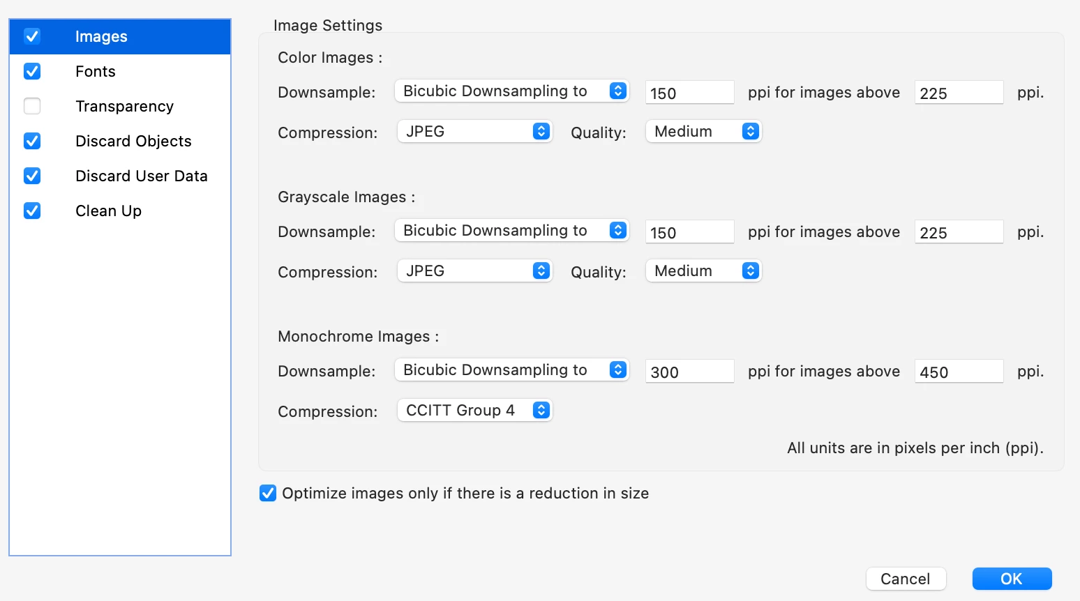

    There’s no way to control the resulting file size of PDF after compression. Like I mentioned, it depends on both the contents of the file AND the compression settings. PDF can contain a mix of raster and vector elements, each of which can be affected by the compression differently and often in an unpredictable way.
    Frankly, I’m not sure what “Acrobat Std” is. Is it Acrobat Reader or the full version of Acrobat?
    In the full version you can control various compression settings, some of which require advanced knowledge of PDF structure. I don’t know if they’re offered by Reader:
