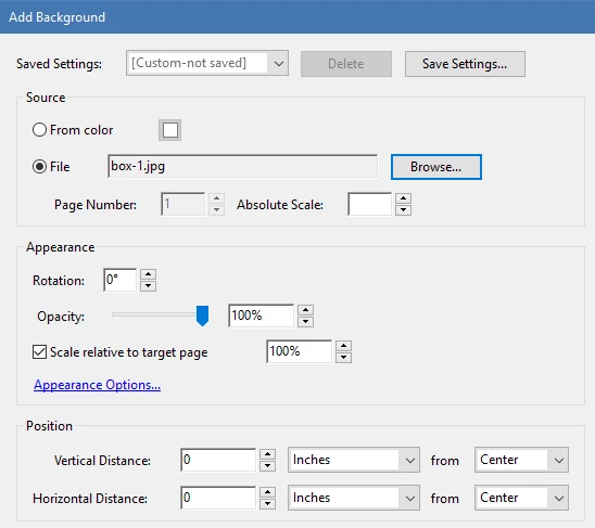

One trick that I have used in the past is to make a jpg file that is the box.  Then, in the Edit PDF toolset, I go to the 'More' tools, and add a Background:
You can tweak the position, size, etc. before applying it.  You can even specify to what pages the image is added.
I hope this is helpful.

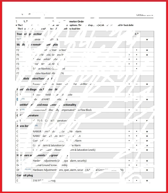

Bellow is the paper that i use (500 times) and the RED rectangle i insert this from tools.
Based on the following (see bellow-that's what I wanted - The red rectangle I insert this from tools then rectangle.). how will my JPG file look like .Where and how is this JPG file created?

I start by inserting a rectangle on page 1. I do this by inserting "rectangle" with tools. This rectangle appears on the full edge of the page. I can choose in the rectangle properties for the color ( black, red, etc..) Now I have to do this 499 times.
yes its a paper (pdf) with some text and technical stuff. But around the page its white. How is it possible do this?
Below is the paper and the red frame is exact what i want.
