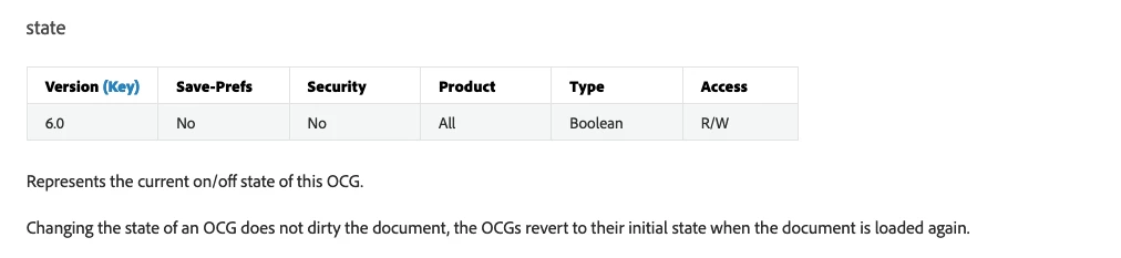

Based on  the code above it is working exactly as I would expect, you are setting the initState, which is the state is it initialised to when the document is opened, and are note setting the State ( that line is commented out), so this means that it will not do anything until the document is closed and opened again.
as stated in the documentation -
If you uncomment the state line, then the code should work with out closing and opening.
