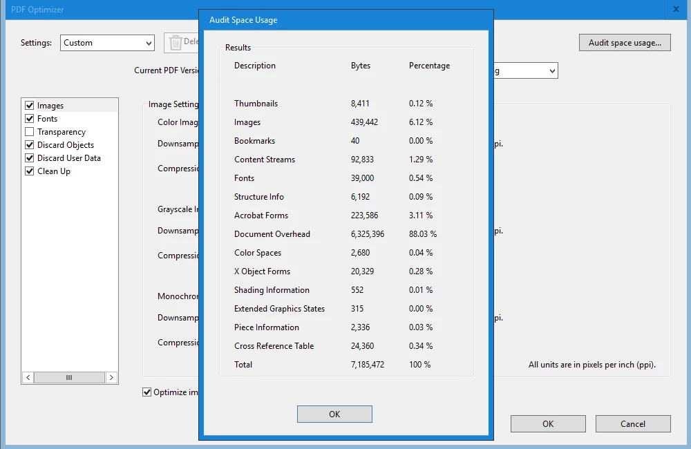

What does you see when you use "Audit space usage..." in the PDF Optimizer?
H&P1Author
April 23, 2019
Hi I see

Go to File - Save As and save the file under a new name.
