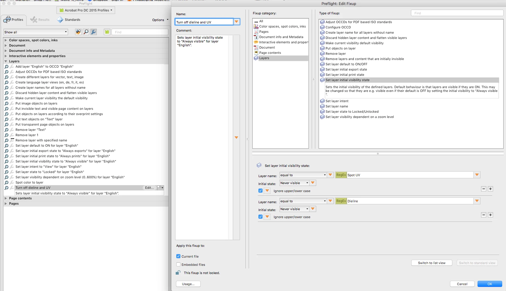

I was able to finally get a result I was looking for.  I was having difficulty getting a droplet to work correctly.  When I went to create the droplet, it didn't want to show me my custom fixups.  I was finally able to get it to work by using "remove spot color set to overprint".  Since all of the layers I wanted to remove are set to overprint and we don't use this setting any other time, this worked in my instance.  I still wish that creating these droplets was a little more user friendly.  This just seems more difficult that it should be!  Thanks for the help.

You might just need to turn off the visibility of the unwanted layers, if so, you can go to Tools> Print Production> Preflight> Fixups (blue wrench icon) and select Set layer initial visibility for layer English. Duplicate this fixup and re-name it. Edit it to include the names of the unwanted layers and change "Always Visible" to "Never Visible". You can create a new Action to run this preflight.
If you're sure you want to delete the unwanted layers, start with the preflight Remove layer with a specified name.
If your PDFs use spot colors that are not properly on their own separate layers, you can use a preflight to select the spot color and move it to a new layer with the name you specify.
