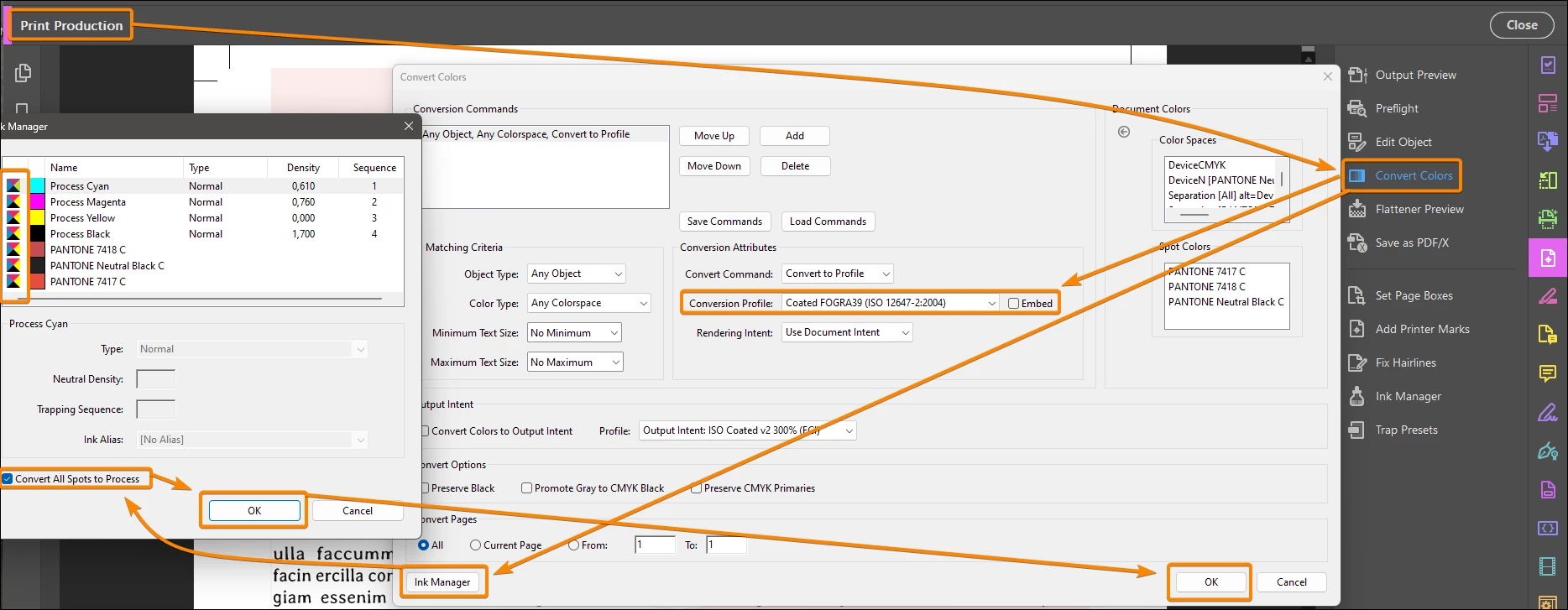

I have a pdf file with spot colours (print marks) on it. I need the artwork without the marks. Is there any way to eliminate the print marks from the artwork and save is as a new?
Correct answer JR Boulay
Remove spot colours from pdf
Go to Print Production : Convert Colors : Ink Manager : Convert All Spots to Process
JR Boulay
JR BoulayCommunity ExpertCorrect answer
July 11, 2024
Amal.
