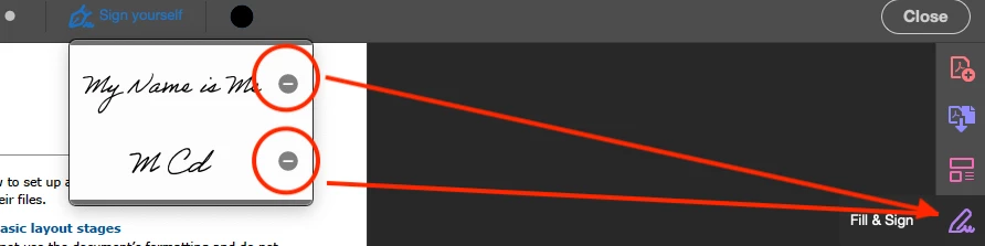

justlearn
May 14, 2025 10:00 AM UTC
@catrina_2782  that's odd because the 'X' would do... In my Acrobat...
I had navigated to the "Fill & Sign" tool, which you can usually find in the right-hand pane or under the "Tools" menu. Once selected, you should see your saved signature. Look for a small minus (-) sign or an "X" icon next to the signature.
Click on this icon to remove the saved signature. If you wish to add a new signature, you can then select the "Add Signature" option and follow the prompts to create and save your new e-signature.

Meenakshi_Negi
May 14, 2025 9:57 AM UTC
Hi catrina_2782,
Thank you for reaching out, and sorry about the trouble.
The signature should be removed once you click on the "X" icon. We checked, and the feature works fine on our end.
Please try relaunching Acrobat and then try. If that does not help, try repairing the application installation. In Acrobat, go to Menu > Help > Repair Installation.
You may also remove the signature from the following location: %appdata%\Adobe\Acrobat\DC\Security\
Search for the file named "acrobat_fss_signature_initials" and delete it. That should remove the signature.
