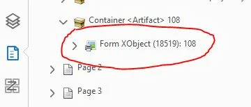

I was hoping someone could help me with trying to delete specific objects that are text from multiple pages of a PDF.  They are essentially Batch Stamped numbers at the top right of the page.  I could manually delete them by using Edit PDF > selecting the object and hitting delete or go to the Content Pane in the navigation area and finding each object there and deleting but if it's thousands of pages, I don't to go to each page to do that.  I played around with Preflight and created a fixup but there were times were it removed more objects than expected and I couldn't tell what it removed.  So I have a few questions.
1.  Is there an easier way to just find all the Form XObjects > Select them then delete?

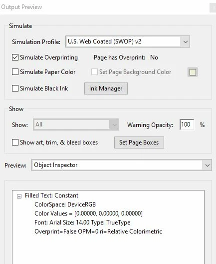

2.  If I do use Preflight Fixups, is there a way to specify a specific Font name?  I tried to type just Arial but it doesn't work, if I remove the font name criteria, the text size and TrueType checks work.  You can see the properties of the objects below.  I used the Object Inspector from Output Preview to find this info.
