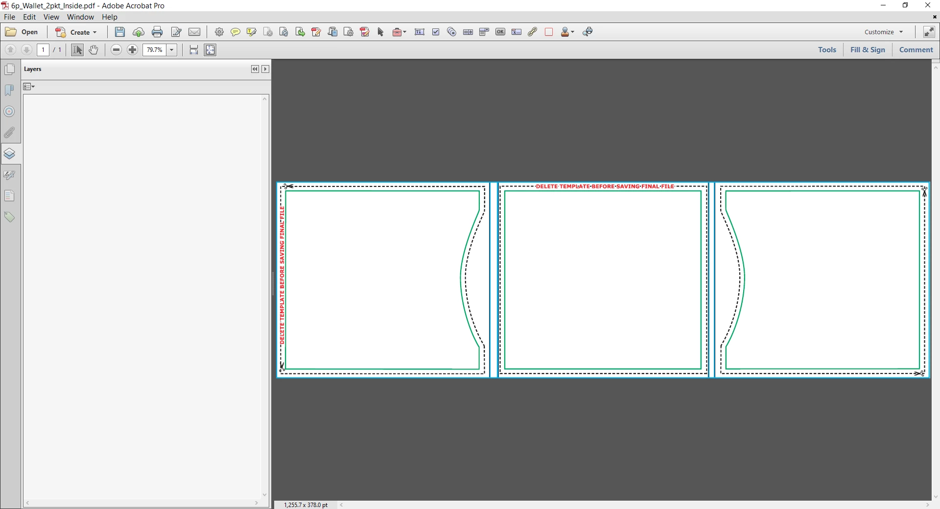

I am new to Adobe on this level. I am designing a CD cover. The process allows you to add photos and text to a pre made template. It then asks you to delete the template guides before submitting the final design. I have no idea how this is accomplished. I will happily explain in more detail if necessary, but I wonder if anyone can explain to me how this is accomplished. I find Adobe challenging to say the least. can someone walk me through this process? The template in question is attached.

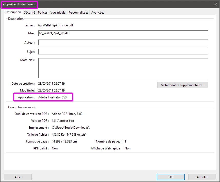

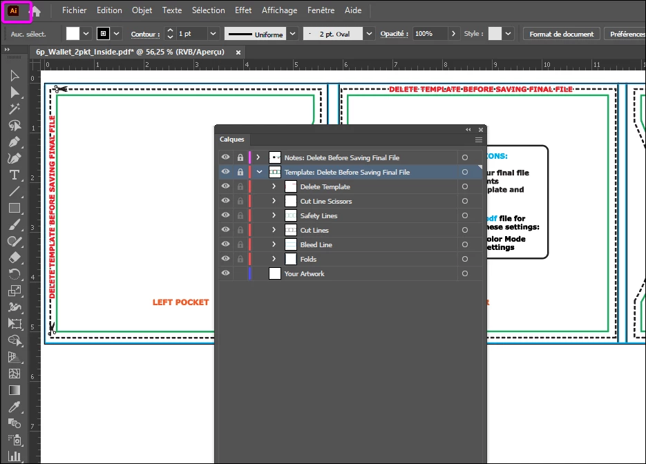

This is a hybrid Illustrator file, saved as PDF using the "Preserve Illustrator Editing" option.
This file contain a PDF file AND a Ai file, so it's fully editable with Illustrator.
Use "Open with… Illustrator" or turn the suffix to .ai  (instead of .pdf).
Calques = Layers

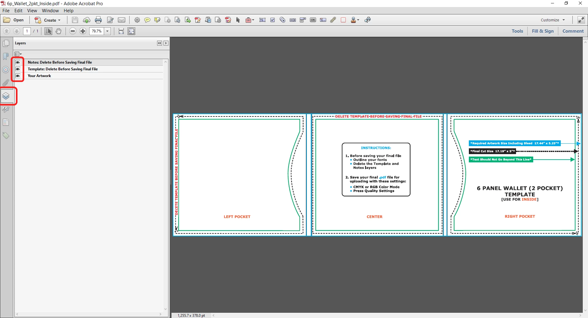

There's no easy way to remove specific layers in Acrobat. You can remove all of them by flattening the file, though. To do that open the Layers panel on the left, tick the eye icon next to each layer on or off (depending on whether you want it to be visible or not in the final file):
Then click the Options button in the Layers panel and select Flatten Layers:
Note this process is NOT reversible, so make sure to save the flattened file under a new name!
The result file, without the layers:

The PDF you have is actually an Illustrator file with layers for the different items. The template guide and notes are on  separate layers unto themselves, so you are being asked to delete these two before you save final artwork (which you would create on your own layers; they have given you one already):
