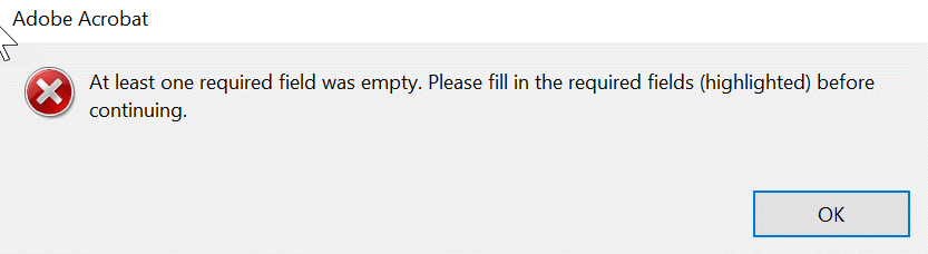

Error: At least one required field was empty. Please fill in the required fields (highlighted) before continuing
I have removed all of the required fields in my pdf but I am still getting this error. Is there a way to search for a required field that may be hidden?

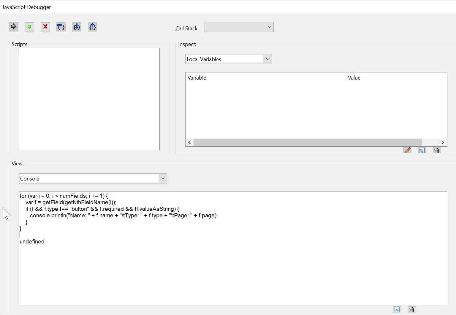

May 13, 2019
I can now enter the script, however the result is "undefined" as per below.
try67
May 13, 2019
"undefined" just means the script completed executing. It seems that no fields were found that match the criteria you specified.
May 13, 2019
That worked. Thank you.

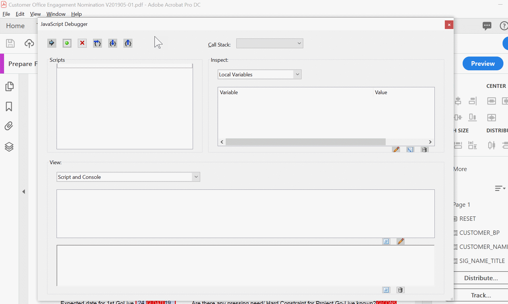

May 13, 2019
This is the screen with the debugger. Where should I enter the script as it does not allow me to type anywhere.
Thank you
Bernd Alheit
May 13, 2019
What happens when you type in the field at the bottom?
