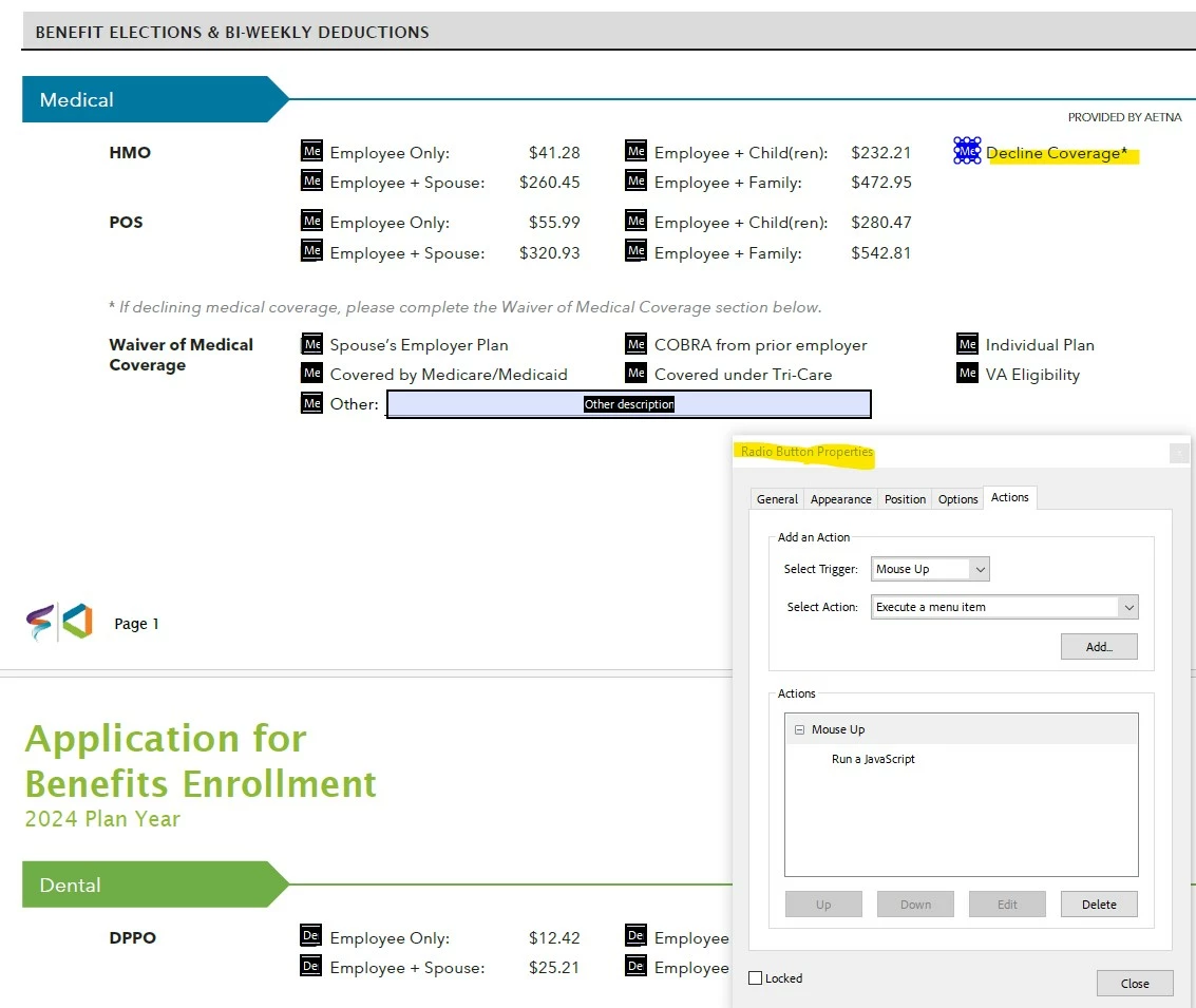

1. I don't see a place to add a Calculation script to a radio group.  I attach an image here of the Decline Coverage properties options.  Could advise where I can find the area to add a Calculation script?

1. No, you won't find it. As I wrote: You can use a hidden text field for this.
