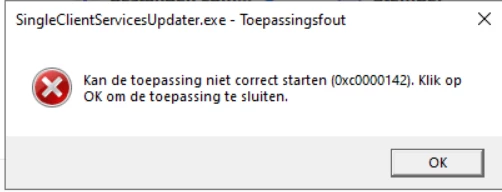

After a little while in restoring the Installation, it gives me an error from
SingleClientServicesUpdater.exe

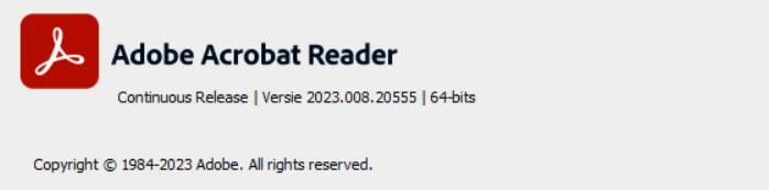

Im running the newest version (2023.008.20555) on windows server 2022 Standard
How do i fix this?
Correct answer Michael35544520nf80
quotation didnt go well,
Anyways I've followed all the steps properly now and the issue still persists, would there be any other fixes? or de we just wait for an update on adobes part?
Was the server 2022 upgraded in-place from 2019/2016?
Check HKEY_LOCAL_MACHINE\SOFTWARE\Microsoft\Windows NT\CurrentVersion\Image File Execution Options
for "rdrcef.exe" or "acrocef.exe" keys, and try renaming those keys if they exist (to disable IFEO for the CEF processes).
This is what i did and it worked

This looks like the OS is catching an error during the installation.
Try the following:
  1. Uninstall Acrobat.
  2. Run AcroCleaner. AcroCleaner — Acrobat Desktop Tools and Utilities
  3. Download a new copy of Acrobat. Download Acrobat installer for Enterprise term or VIP license
  4. Install.
February 26, 2024
I tried it, and it sadly doesnt work.
Would there be any other possible fixes?
I also tried resetting the preferences, by deleting them in file explorer
Along with some other generic fixes
Thank you for your help
